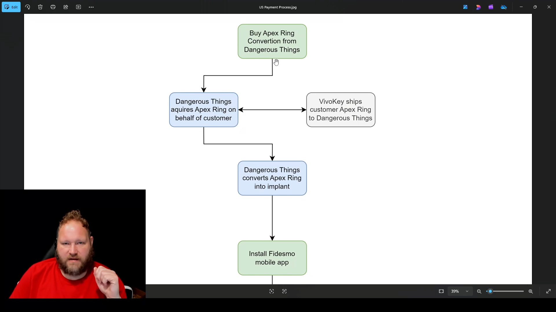

Even though the Apex Ring is no longer offered for sale to the public through VivoKey, Dangerous Things happened to acquire the “right to purchase” from a large tranche of Apex Ring inventory. Rather than sell the rings outright, we are offering conversion services to customers. This is how it works;
  1. You obtain an account from a supported card issuer
  2. Customer (that’s you) purchases the conversion service
    2a) DT (that’s us) acquires an Apex Ring on your behalf
    2b) DT receives and converts the ring into an implant
  3. Tokenize your payment card to Apex Ring conversion
  4. You pay for things with your Apex Ring conversion
