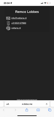

I tried above again.
It works !! Perfect.
Can scan with iPhone.

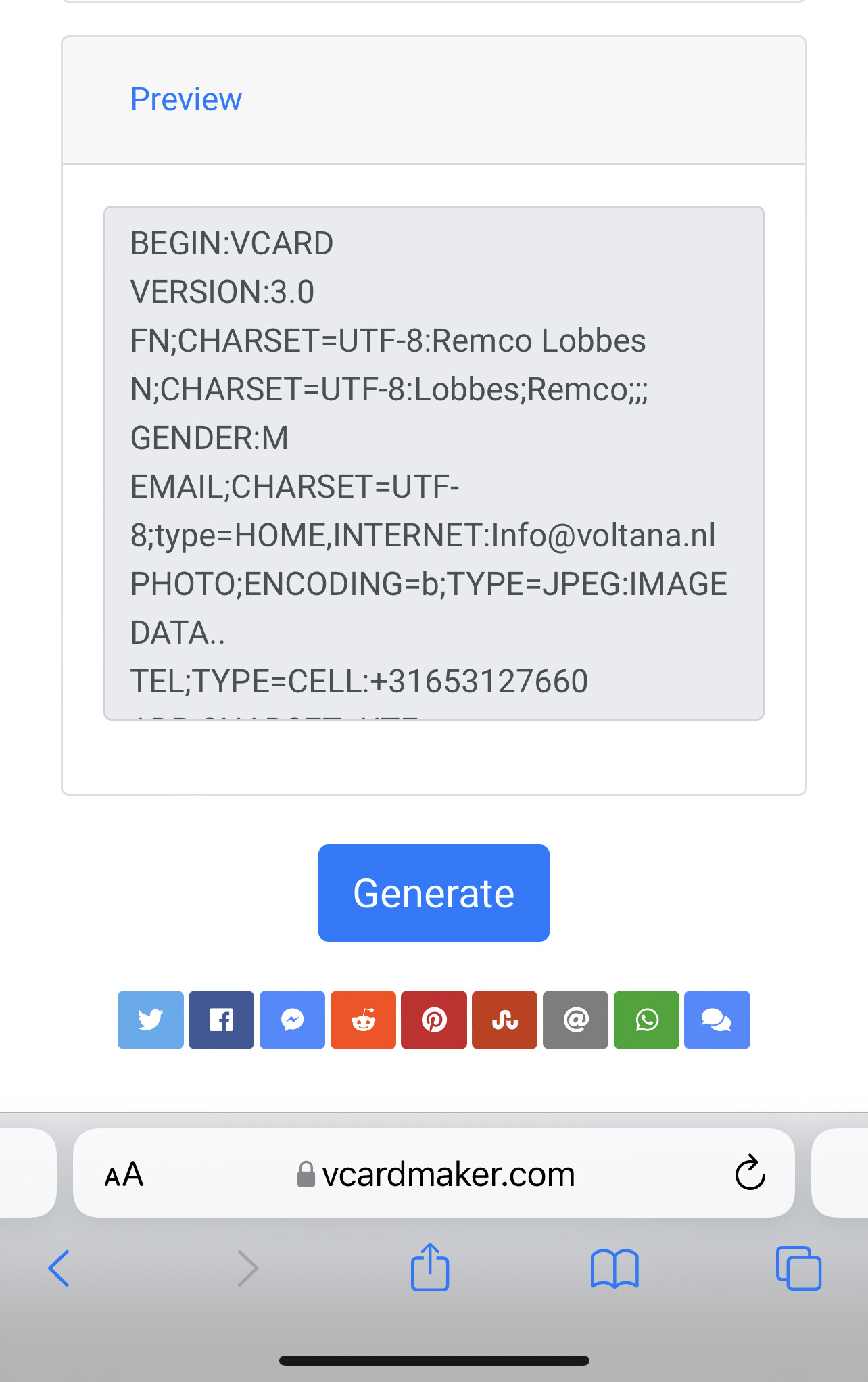

Only V-card does not work.
I get a lot of scrambled text.
That should be even more great so others can save directly in adresbook.
Nice!
I dont quite know what you mean.
If you copy paste this BEGIN:VCARD text into the vCARD field on your edit page you should see this entry:
Clicking that would download the vcard, opening the vcard would allow you to import it to your contacts.

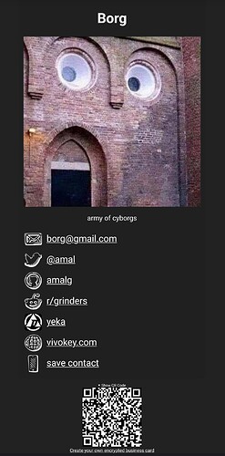

I’ve
  • added some entries, mainly glorified urls so you need to copy paste your profile link
  • replaced the img link, you can now select one, images are stored encrypted ofc (~1.5Mb max)
  • added QR code for phones without NFC
  • enabled custom IDs again (for new cards)
