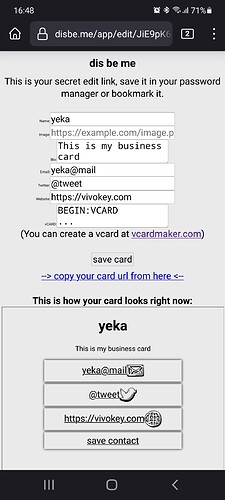

So I have a TLS cert now. https://disbe.me
So technically it’s actually safely useable now.
View this as public beta. As long as my server is safe, no one can get your data.
There’s a preview of the card now and I’ve also added a vcard download.
Selecting contacts is not possible in all browsers and you can’t easily export as vcard… this sucks.
Even generating a vcard won’t work cuz I do not have the details in my model e.g. no name and last name, I just have 1 string called title.
This project gets worse the more I do :wink:

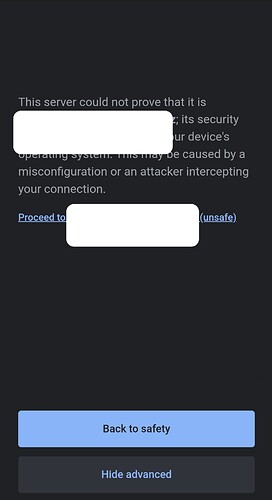

Tried this and it is scannable by iphone but when i click on popup safari says it is not safe.
Site has no certificate.
cannot go further.
Can you not just acknowledge and accept the risk and proceed? I mean it is your phone!
Who is the boss? You or your phone?
I can on my phone
Oh yeah, you have an iPhone, never mind, that answers my question…
Tumblr_mdrg02Z9ju1qz9y4ko1_500
when i go further it says: No password found, scan the nfc again to see this buisiness card.
I get same screen as you do.
@yeka will be the guy to help you out, This is his brilliant solution, he will have the answers for you
What?! But it does have one…It can not even serve content unencrypted. I have this certbot thingy actively renewing the cert, so this shouldn’t happen.
Weird…
This should only happen once you’ve reloaded the page. It’s so that people you give your link can’t easily safe it forever. There’s a hidden checkbox to disable that.
I’ll check this when I wake up, I probably ducked something with the certificate.
