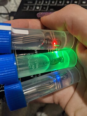

I’ve recently gotten some of Paul T’s implants -
The red and the blue ones aren’t actually that much dimmer than the green, I was just struggling to get all three of them to couple with my PM3 easy at once
. The green is the brightest however, followed by the blue and then the red one. Quite happy with the brightness out of the body, but I’ve also never seen an xLED / xSIID outside of the body so kinda hard to compare brightness until I implant one.
