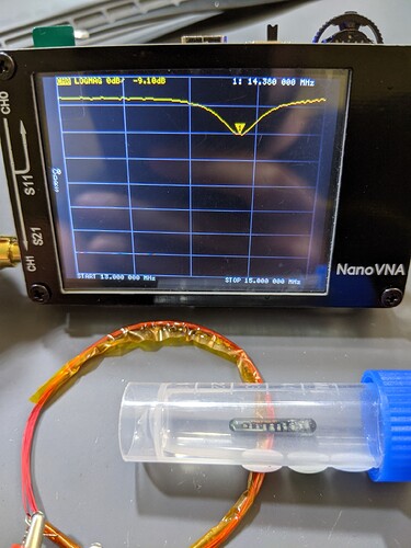

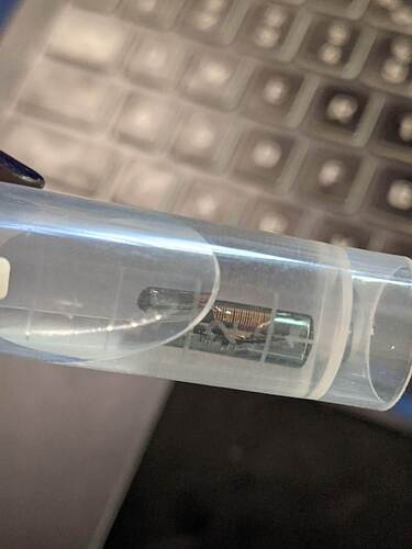

Ok, so a member has tested the resonant peak of someone else’s implant’s antenna and they seem quite high (above 14MHz), and also looked at the antennas and they aren’t totally consistent. Here are some pics of the antennas in two of my implants:
The sealing actually looks really really high quality, though it is flame sealed. I believe it’s Schott glass, and the sealing procedure was from communication with them (and the quality seems to reflect that).
At this stage, the main thing I’m concerned about is the coupling, though the skins capacitance will bring the resonant peak down.

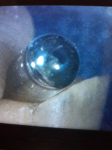

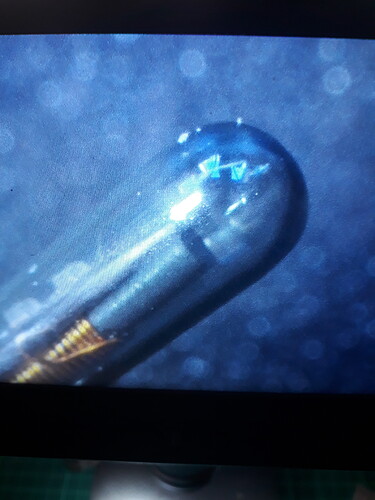

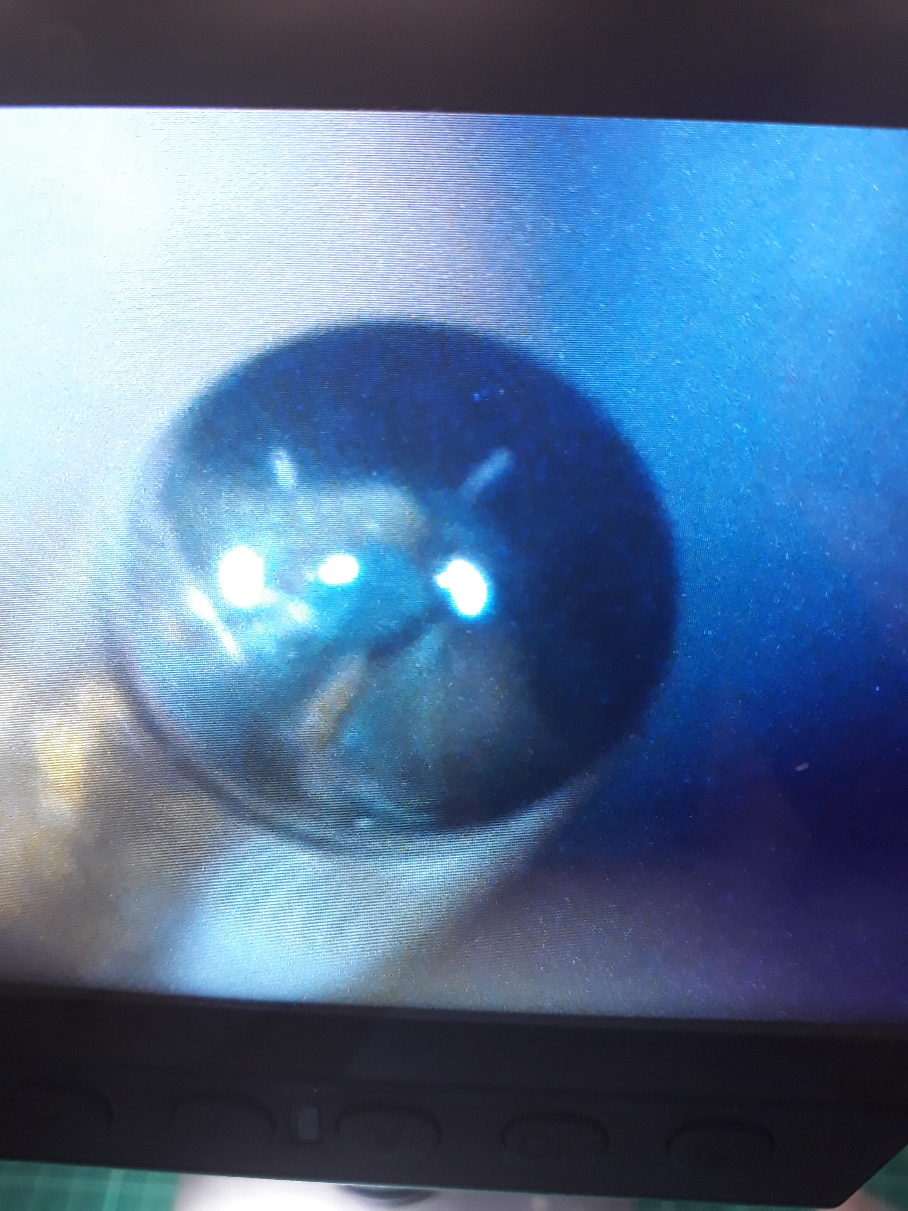

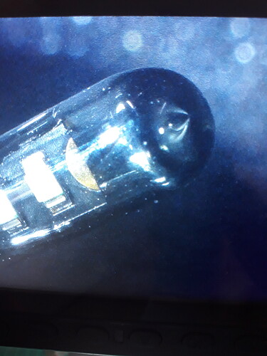

Some pics of the sealing under the microscope from Paul himself:
Look really really consistent, with no blobbing like we’ve seen from some other RFID implant manufacturers.
