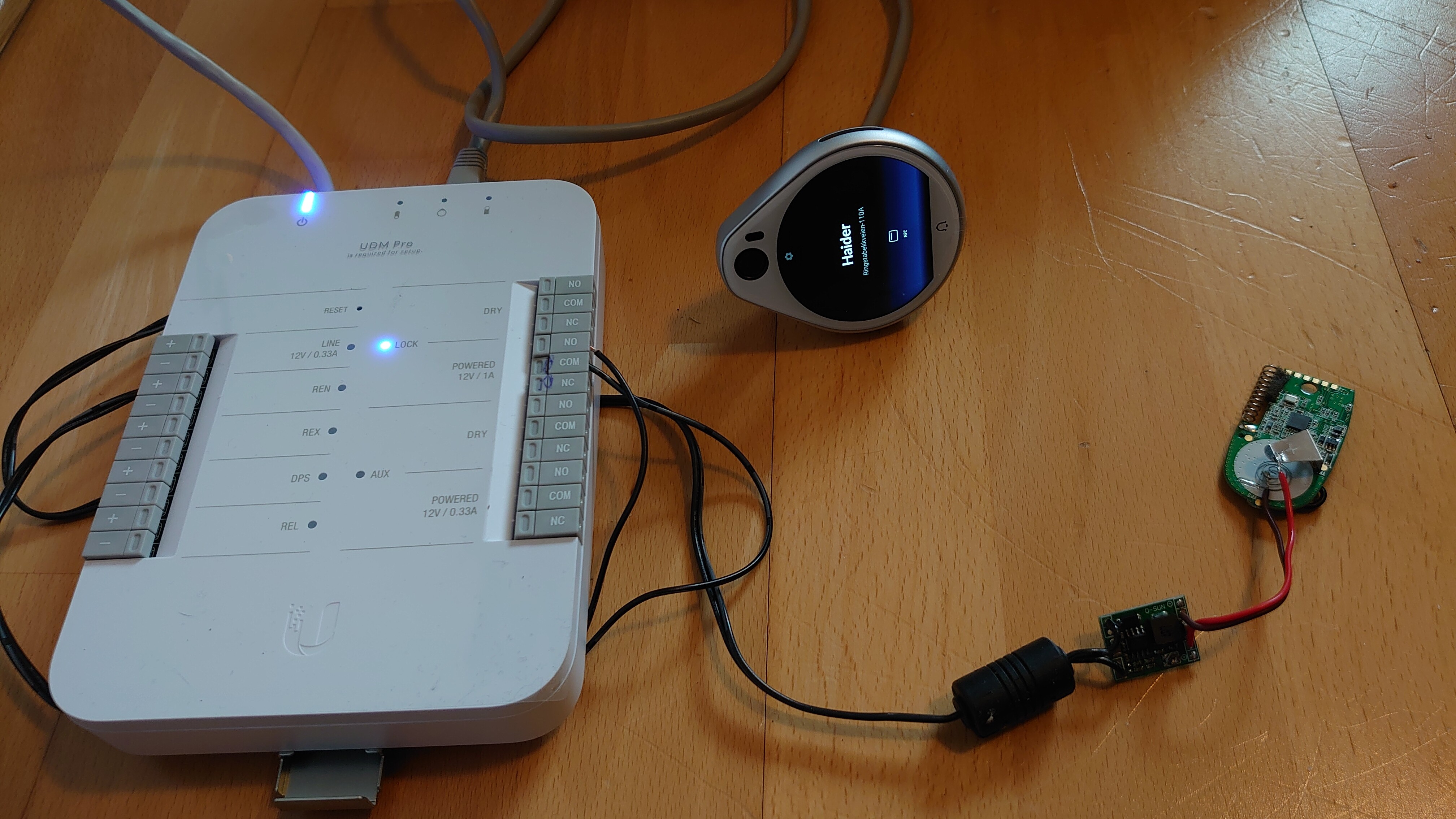

Thanks to @chipman, I also ordered the Unifi Access starter kit.
I have a Yale Doorman lock, which works relatively good, but I sometimes get slow reads.

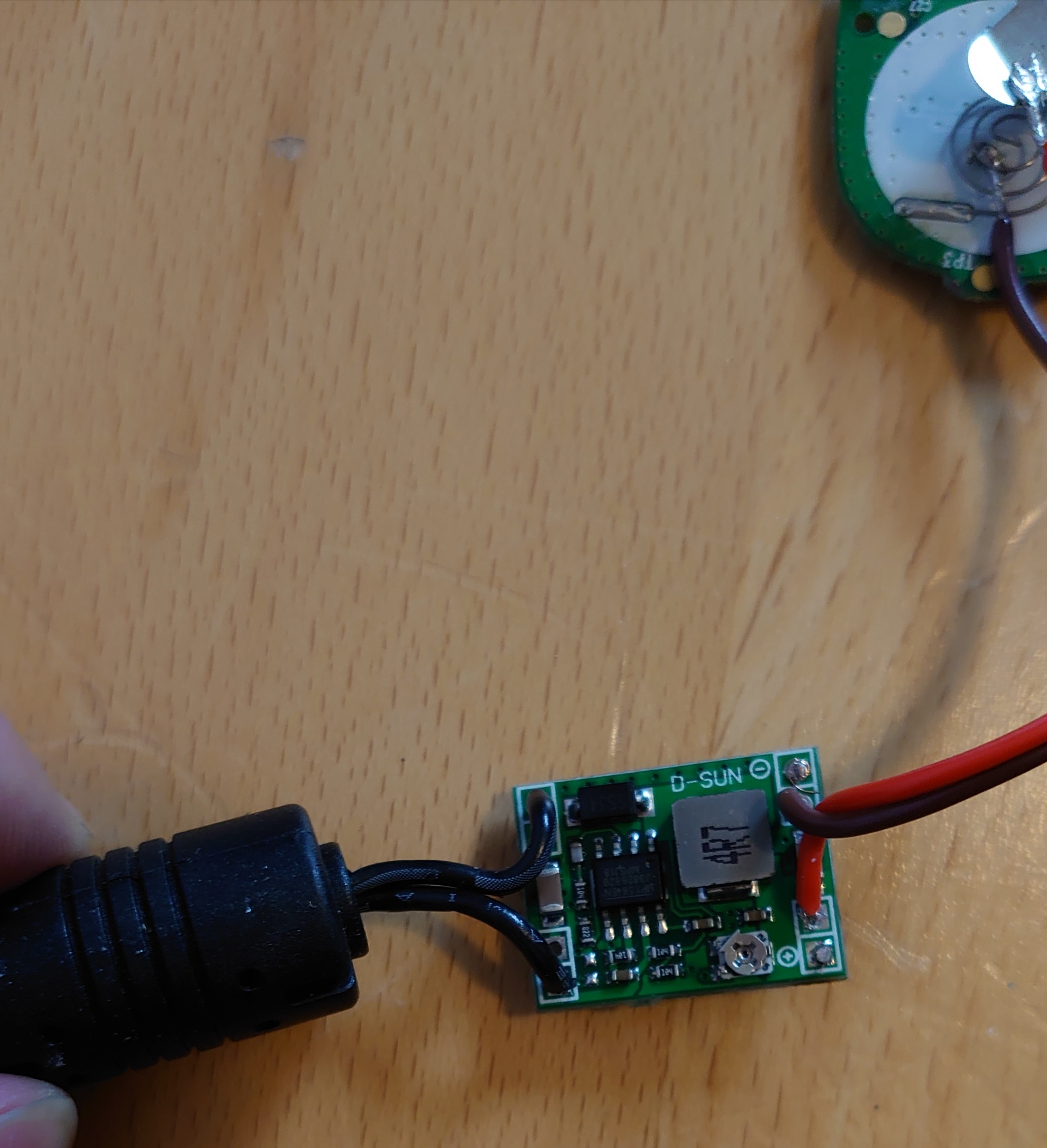

Purchased a keyfob for the Yale and gutted it,then shorted the push-button to unlock the door
Next step was to solder the battery connection to a voltage regulator, tuning the 12v power from the UAC down to 6v which the remote requires
Final setup: when an approved access card or chip is read, it sends a 6v pulse to the keyfob which in turn opens the door lock.
And after some drilling and swearing, here is the final result, - comparing read time against the Yale.
@anon3825968 : the UAC is definitely more consistent and easier to get a read, (probably because it is powered and therefore doesn’t need to pulsate)
