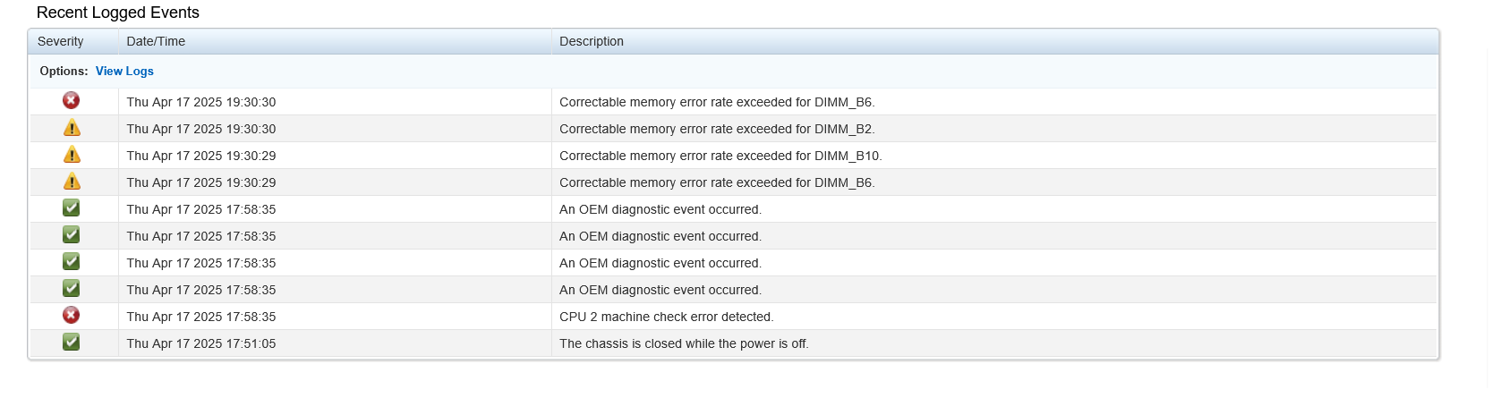

It seems to be struggling with the memory / ram. It had a few error messages about specific ram slots, all in the B section. Also, I put all the new ram in the B section, and all the old stuff in the A section. It’s currently chewing on “configuring memory”. Google says this may take awhile. If it persists long enough, I’ll probably try moving or removing the specific ram it doesn’t like. Maybe I can eliminate the ram sticks or the sockets.

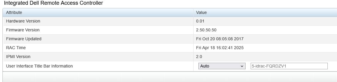

I checked, and IDRAC is accesible, doesn’t need to have the firefox settings tweaked to access it, and has the enterprise license so I can use the dedicated port and a few other features.
Also, I looked at the memory error codes.
