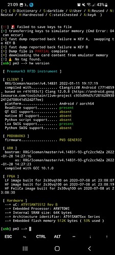

In the evening it was still working, in the morning of the following day it was no longer working. It stopped working from now on. I didn’t hit anything with my hand. I tried different readers to read the implant. Various phones, the Proxmark3 and the ARC122U, all to no avail.
it was installed in January 2022. It didn’t happen unusually. In the evening it still works the following day, it was no longer readable. It is no longer recognized.

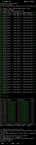

Recognized as in the reader doesn’t read anything, or not recognized as in it knows something is there it just doesn’t know what it is? Maybe try to see if the Proxmark3 recognizes anything when you something similar to this post?

No reader can read anything. Like holding a rock up to the readers, nothing. The XM1 is just dead. As I said, I’ve already tried it with the Proxmark3.
Do you get any reaction at all if you do hf tune --mix in the Proxmark3 and hold the chip up to the HF antenna? You should see a noticable dip in the voltage.
Hmmm. I’m not entirely sure then. I hate to say it, but your chip might actually be dead then.

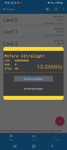

Earlier I picked up my cell phone and suddenly the implant was recognized. I immediately opened Mifare Classic Tools and was able to read it out normally, all the data was there. As if nothing had ever happened. A few minutes later it was dead again. It seems to have some sort of loose connection. I tried cooling it with ice and warming it up with hot water to see if it might work again. Unfortunately without success.
damn… i think you might be correct. this seems like a bad connection either with the chip to the carrier board or the carrier board to the antenna wire.
