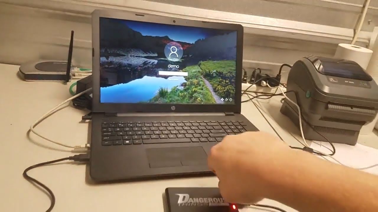

haven’t hooked up the reader as part of the package from DT because I really don’t know where to start or how to use it.
Are you taking the KRB1?
Just plug into your computer (no drivers needed) and scan your NExT or Spark2
It will “type” in the active field your UID from your implant.
So you could just use it as a pin/password, you could even use both to make one long password
