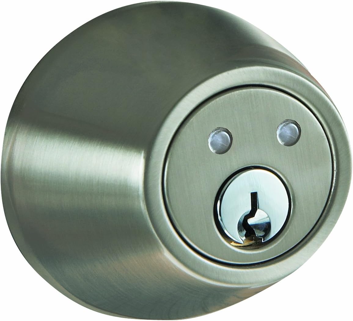

There are some rfid remote controlled deadbolts such as this, you could in theory hook up an xac or similar to interact with the unlock button on the remote.
