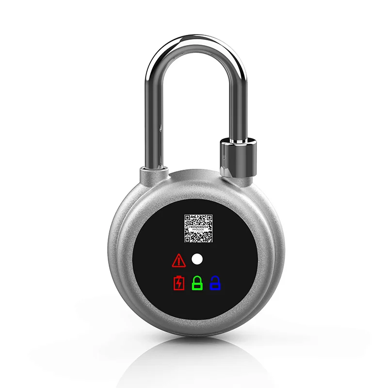

I still want a damn lock lol
It’s obviously chinesium, but maybe it will work?
It’s cheap enough to maybe be worth a shot

In term of lock/padlock, a few of us have some experience/interested with physical security (pick/bypass) and are looking for an NFC enabled lock that doesn’t sacrifice every elements of security.
Most (if not all) electronic door locks have junk backup cores and most padlock can be pried open with no tools or bypassed with no skills and/or very little tools …
If you’re planning on lunching a new product line, I’m happy to test them and provide my thoughts and feedback (it’s part of my current job [R&D testing and service/support])

  1. Move to iso14443a
    Iso15693 is a far more uncommon, iso14443a is much more popular, and even among your non bio hacker customers it would be beneficial as they would be able to purchase stickers,fobs,iso cards with far more variety… giving customers options in how and what they use with your product will allow it to be used in more applications
Potentially also compatible with phones
  1. Make sure you keep the ability to enroll new ids or cards, if not it would break many use cases… including this entire community
3.Keep the antenna as close to the face of the lock as possible,
I recently bought a 14443a padlock, that was rendered useless because the antenna was on the back of the circuit board, and about 5-6mm deep… this caused almost no read range with implants
  1. Backup power
A usb plug (not mini for god sakes) is ok, but a hassle if you need to find a usb battery, I think the 2 contact points for a 9v would be great
I would be happy to send to a low quality imitation of a 14443a implant if it would help get a lock that would work better for us

I have a couple of locks with that option, plus yes a Type C is another good option.
I know you can plug two phones together Type C to Type C and charge one of them from the other, but the charging is controlled from the receiving phone so I don’t know if the is active power delivery without smarts at the other end to control it. Maybe a Type C-PD in the padlock ( or door lock etc. ) could work.
I carry both a 9V and powerbank with me in my backpack, but I don’t know which would be the better option as far as backup power for a padlock, and which is more common for people to have or have access to
Much more common to have a power bank …
9v external connector are great but i dont always have one on me … it usually stays in my tb for my multimeter
