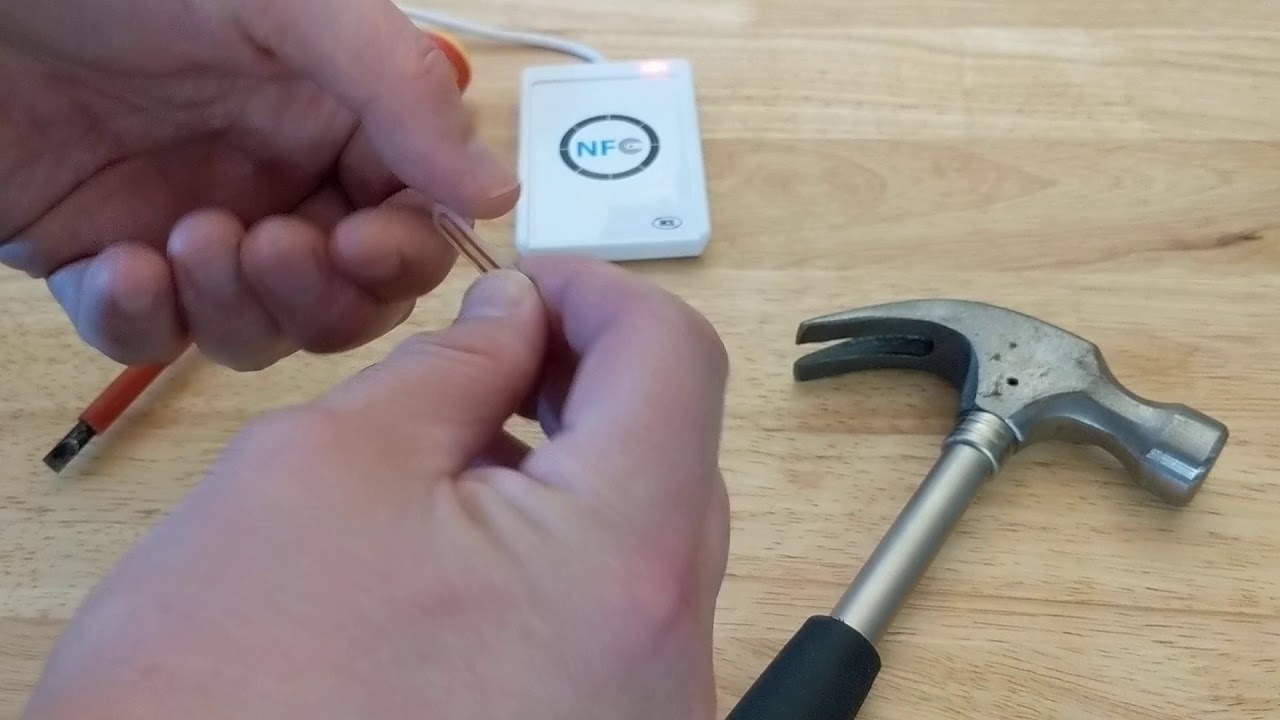

There are no negative impacts to the flex device if it crosses or lays atop bone. There may be some irritation or other possible issues from the body, but the flex devices are fine over bone since they are not glass tube like our x-series. Flex devices are quite robust.
This is the interesting bit. What kind of stuff can happen + is it permanent or just longer healing?
well as @Satur9 mentioned… tension could be an issue… where the flex is basically “pushing up” from under the skin because it’s being cantilevered over a bone or something like that. In the case of planning to go over a bone, it would make more sense to put it perpendicular across the bone than the try to lay it parallel with the bone because the flex antenna is much more flexible length-wise.

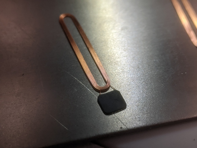

I have a prototype breadboarded tag here that I was working on a while ago that contains 3 chips to a single antenna (coil). That isn’t 3 chips connected in parallel, that’s 3 that individually switch and dwell (as a user you wouldn’t know) when presented to a reader. No card clash! The idea is that you can have multiple chip types in a single tag, or even several of the same. Single chips, pairs of or all 3 are selectable from a phone/reader. There’s LEDs :wink: to let you know which chip/s are selected.
The design also has the ability to match for a range of chip impedances. My prototype contains 2 backdoor mifares and an NTAG at the moment.
Now if you had the same tag with 3 of the payment chips inside you could register and enable chip 1, after 3 years enable chip 2 and then a further 3, chip 3. Effectively 9 years from the one implant. I suspect what would happen though on the expiry of chip 1 and enabling chip 2 the providing company would get all suspicious over a 3 year old dormant tag coming onto the system, get all bent out of shape and disable it……or perhaps not. Wait ‘til you present the 6 year old dormant tag!
