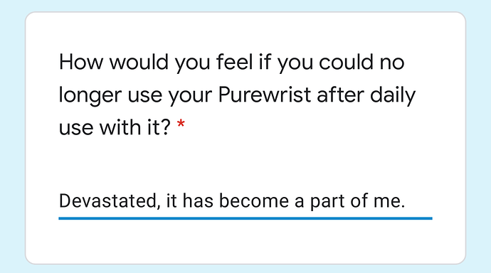

Hahaha, it has become a part of you? Hehe ![]()
Not to drag this out again, but shouldn’t the question be “How would you feel when you will no longer use your Purewrist after daily use with it?” It will expire after all
Or is the replacement date already in your agenda?
The comment was more a joke on the feedback form to confuse the reviewer. I hold no allegiance to this payment implant, it’s a tool just like my others. Even if it does last for 3 years, I’ll almost certainly have it removed before then. I semi-regularly switch out obsolete implants for newer ones. Thus is the nature of “upgrades”. Even someone with a prosthetic leg has them tuned up and switched out regularly.
