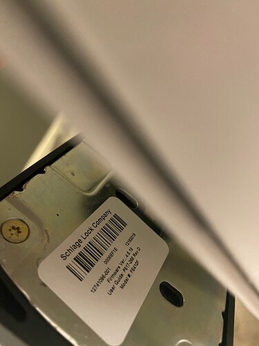

Interesting the Schlage user guide above makes no mention of the protocol or RFID type etc. But I was able to unscrew the entire door lock and got the model number etc (attached photo) So what now? I guess my only option is to buy a diagnostic card? or if they are both low frequency am I good to go? Baltimore here. Hopelessly, technology unsavvy here. Thanks for all the responses.

The Schlage FE410F data sheet says
Credential: Supports smart and multi-technology aptiQ MIFARE classic or
aptiQ DESFire EV1
DT sell options for both of these
MIFARE classic
xM1
FlexM1 gen1
FlexM1 gen2a
FlexMT
DESFire EV1
FlexDF
but also likely to work
FlexDF2
xDF2
I still think we have a bit of work to do here to get this correct for you.
Of the above, Initially I would suggest you go down the Mifare path (because you can change the NUID numbers) however the DESFire are still viable.
If you can enroll them (home SHOULD be easy) Work you will need administrators on side.
If you can’t enroll, then of the Mifare, the FlexM1 gen2 would be my most reccomended, ONLY because you can use your phone to change the UID.
Otherwise you would need to buy a ProxMark3 and I don’t think you would have fun setting it up.

The fob number you mentioned near the beginning is dual frequency, that isn’t a problem. There are dual frequency implants, and I wear a dual frequency ring.
Most locks I have played with use NFC (high frequency) but only really care about the UID.
The elevator reader appears to be low frequency. A diagnostic card will confirm this but it isn’t necessary. A proxmark 3 easy should make it easier to clone your fob. I am not sure that the low frequency side can be cloned with a phone to be honest.

Those Schalage locks are usually MFC but I have seen one that’s Desfire. Given you said it’s run by less tech savy individuals, I’m leaving more towards MFC since its the easier tech to implement.

After a brief bit of digging I think your lock is also part of an access control system. Meaning that your building management gave you a key fob and they programmed your lock to accept that fob, through a central control system.
This doesn’t change much, it just means that you have to clone your key fob rather than add a new id to the lock.
This means that you probably need a “magic” NFC chip rather than just a regular one.
