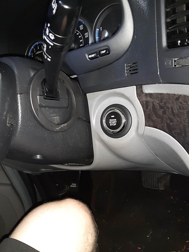

Yes and no. For most cars, when you remove the ignition cylinder, the car is in ACC2/ACC1. This being said, yes you can remove the ignition cylinder and yes you can use it to turn the car back on. I have a bad habit of leaving my interior light on in my car, and killing the battery(this predicates my adventures with modifying my car) so I keep the old keyed cylinder in my glove box and I still have the keyhole on the door. I ended up mounting the push button in the hole where the old key used to go. Oh, and remember to disconnect the wire brick from the back of the old ignition cylinder. This will prevent anyone from just reaching in and turning it to start the car, and will also prevent the car from staying on in ACC2/ACC1

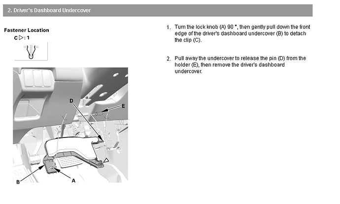

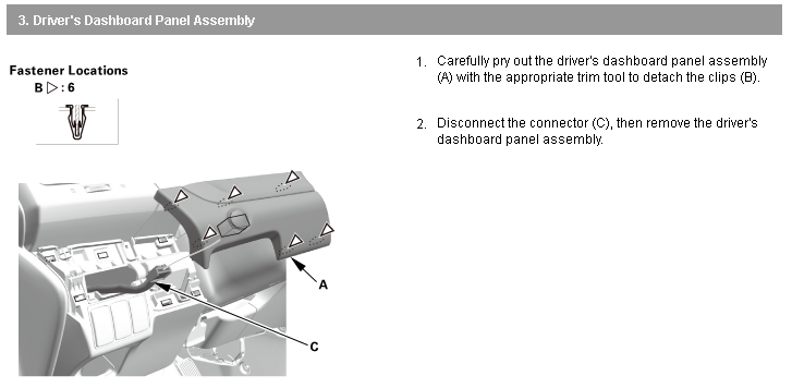

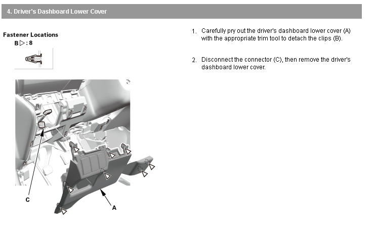

Uhhh… I can’t figure out how to get the driver’s side lower dash off on my CR-V model (2014). Off to see if the CR-V forum can give me instructions on how to do that…
Would this help?
http://www.crvclub.ru/manuals/CR-V-2_manual_eng/manual_uk_shop/group_7m.htm
the power of Google is strong with this one
Nah, that’s what I was originally using but it’s for an older model of CR-V and the screws aren’t in the same place (I don’t even see any screws on my car).
I guess I should have mentioned that I was using that. I should have figured you guys would try and look it up to help :sweat_smile:
Grab yourself a Haynes manual
I figured it out! I saw that the newer CR-V models had panels that just popped out so I put a little bit more force on mine and the panels popped out! I’m just trying to be careful so I don’t damage anything.

Hopefully these might help. If you need any other instructions or resources let me know.
EDIT: I thought I should specify for clarity. I have access to the internal network for both Honda and Acura and can provide it for you.
Instructions taken from Under-Dash Fuse/Relay Box Removal for 2014 CR-V
