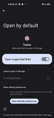

I did it! I had to go into settings > tasker > more > set as default > always

You’ll want to do what @non-bin suggested. settings > tasker > more > set as default > always. You might not have that exact wording, but your system settings should be fairly similar.

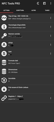

right now with NFC tool pro i have programmed link B like this:

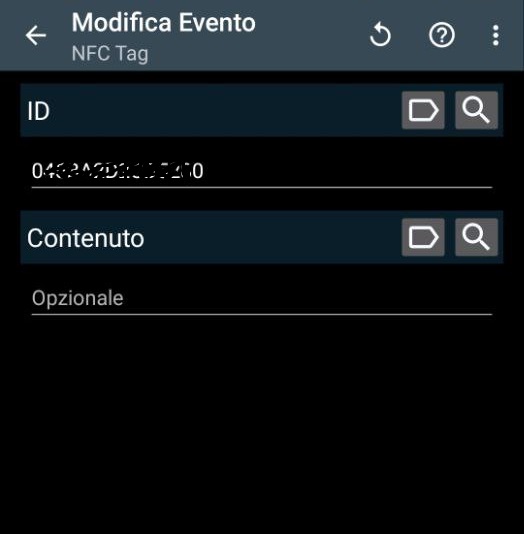

then with Tasker I created this profile (event):

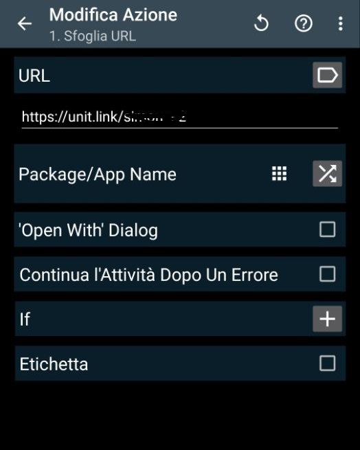

and associated this activity (action) with LINK A:

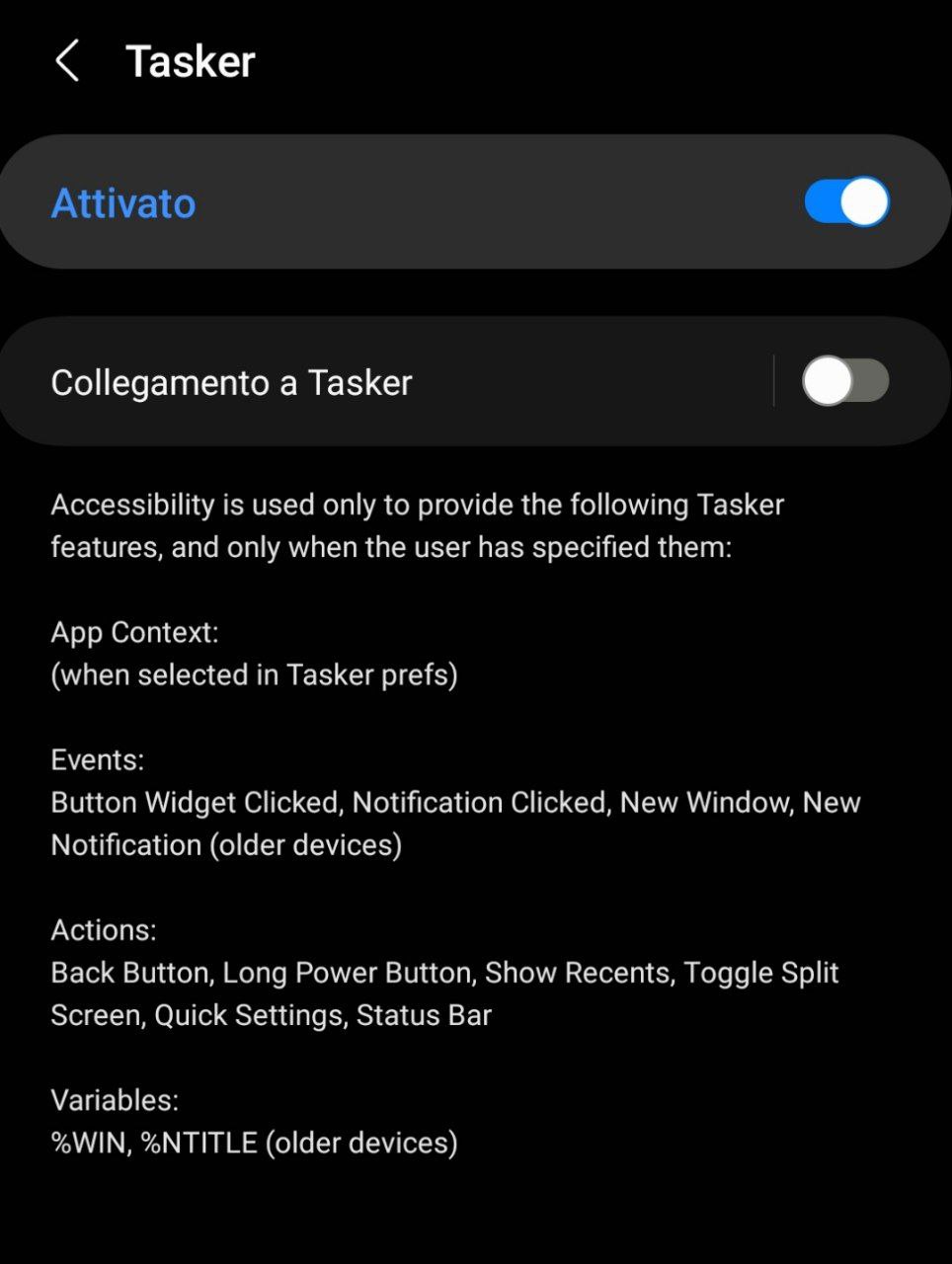

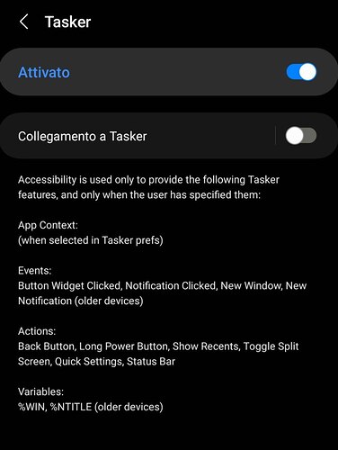

in the settings of my smartphone I did this, in accessibility it is like this:

I think you need to go into the Tasker app preferences and clear default opening preferences
I don’t know if that’s what your screenshots say. You get to that through
settings > apps > tasker
I’ve got notifications off so make sure to tag me
Hi @non-bin,

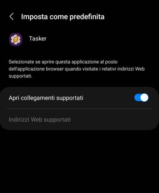

exactly as per my image sent in the previous post:
settings > apps > tasker>set it as default
f67285b3165847b736eda014d173b71641ff8e9f_2_411x500
i have this as your screenshot.
but according to you TASKER i set it properly to make my smartphone open the correct link ?
