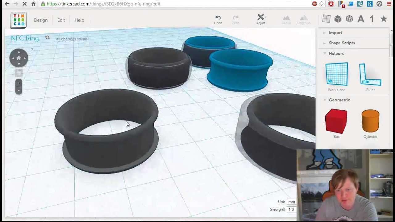

Source a P71 chip and build your own ring
Check out printables or thingiverse for an NFC ring file
P71 chip and build your own ring have you got link to see whatlook like ?
something like these

thank’s but how can i put smart card in a ring :slight_smile:
2Gb
and some Acetone.
Disolve the plastic
Reuse the antenna wire for your ring antenna
