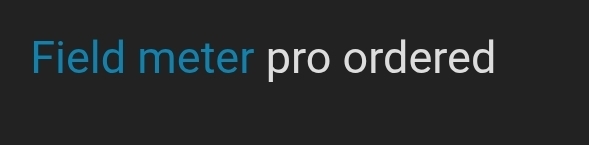

Field meter pro ordered
I updated the field meter pro hyperlink, Thanks for the reminder
Also
Good choice.
The Field meter is really good and does MOST of the things, but the Field meter pro version is next level and does ALL of the things
To be blunt, 60% of the things I really want to measure are battery powered, so the digital-only field meter would be kinda underwhelming for me.
