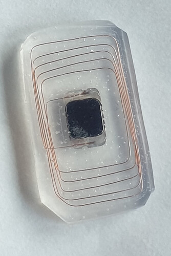

If you want to post a picture of how bendy is your product…
You want to show people that even if you bend it, it still works… Right?
Or have I missed something there?
Because what that picture clearly shows us is…
If you bend that implant, and then get it really close to a reader…
The reader does NOT read it anymore!!
(see the red light on the reader? indicating it is not reading the implant)
:joy:
It’s clearly a safety feature, you can disable the implant by bending it to protect yourself against unwanted transactions while you’re asleep! :joy:

from what I gather, the first batch of these is what failed on pretty much everyone… so literally the first set of 10 like 7 failed within 1-4 weeks of installation.
I’ve got new ones coming in the mail from a biohacker in Germany. I’ll test them out and see how they hold up. @amal , can you send me any old flex implant so that I can test side-by-side? The only ones I have lying around are prototypes or ones with compromised encapsulation.
Its full of air bubbles
Hush, they might not notice the bubbles. Perhaps the sharp corners are to distract from the bubbles (or vice versa).
I believe that you can use a vacuum pot to remove those bubbles during casting, so I am not sure why they didn’t.
Ignorance or indifference or incompetence are pretty standard guesses
…oops did I say that out loud?
Ignorance - a quick Google search about removing bubbles from silicon castings would resolve that.
Indifference - the bubbles make it look like the product was produced by someone who just didn’t care. So while they might be indifferent that would make me shy away from the product entirely. If they are indifferent to sales then why bother at all.
Incompetence - No cure for that one.
So, basically if they want to be taken seriously they would have clear, bubble free silicon with smooth, rounded edges everywhere.
It’s actually really difficult to completely evacuate all the air from silicone, and it’s especially noticeable when it’s transparent. You not only need to evacuate the air from the mold, but ultrasonically vibrate it at the same time. If DT made silicone encapsulated implants it would likely be similar. The difference is that Amal had the foresight to decide not to.
I’m not trying to throw shade on iamrobot. I would implant this device, I would just like to know the limitations before I did. The free sharing of information has always been a core component of biohacking. Unfortunately when it’s a business, the desire to market overcomes the desire for transparency. That’s why you need informed people taking things apart and giving reviews :wink:

Immagine the bad consequences of installing one bad product in a bunch of people… it hits the media… general public, or even newb potential body hackers, would be unable to identify that those bad consequences were caused by one stupid company selling chips with sharp edges and encapsulation issues.
Especially if said company uses shady marketing strategies (such as lying through their teeth or forbidding people from talking about their issues).
