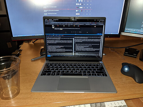

I’ve been meaning to do a little write-up for a bit now, but I’ve been caught up with school. I posted back in May, and later in July about the Framework laptop.
I purchased it as my new school laptop, after my old one decided to die on me. Thankfully, I got a hefty COVID grant through my college which managed to cover it.
People seemed interested in it, so I thought I’d leave a brief review. I got mine a few weeks ago, and I’ve had 0 real problems with it. Assembly was very quick. I got the DIY version, so I had to install my own RAM, SSD, and wifi card. I just followed the online guide (laid out similar to an iFixit guide), and I had it running in less than 10 minutes.
My version is the i7-1165G7 model, and I installed 32GB of DDR4-3600 and a 500GB Samsung 980 NVMe SSD. I often run VMs, as well as doing a lot of data processing, so 32GB of RAM made sense. It’s also nice to have a ramdisk for SDR uses.
Pros:
  • Somewhat official linux support
  • The fit and finish is very good, IMO comparable to a Macbook. It feels very solid, with very little flex.
  • The trackpad is quite good, the best non-Mac trackpad I’ve used. Two and three finger gestures work great.
  • I love the 3:2 screen, fantastic for getting work done
  • The HiDPI screen looks fantastic
  • The keyboard is excellent, one of the best laptop keyboards I’ve used.
  • The expansion cards are fantastic, and it’s annoying now for me to use any laptop without modular ports. I normally keep it stocked up with mostly type-C ports, but if I know I’m going somewhere where I’ll need a type-A, I can just pop it in. Charging on either side is nice, too.
  • The hardware cut-off switches for the mic and camera are excellent, and I wish every laptop had them. No more shitty sliding covers.
  • The power button is a fingerprint reader, and it works with fprintd (thanks to upstream patches by Framework)
  • They weren’t kidding about repairability. It takes me less than 5 minutes to remove the display. That’s unheard of in modern laptops. The magnets instead of clips are excellent.
  • The Xe graphics are pretty good, and can run most games just fine. Minecraft, Factorio, Stardew Valley, all run great.
Cons:
  • The screen is glossy, which I don’t normally prefer. It’s not too bad, but on a sunny day it could be annoying.
  • The battery life is poor, generally 5-6 hours. There’s some standby issues in linux, but fixes are being actively developed by the Framework team, and they’ve been trying to keep everyone in the loop. Thankfully, since it charges with USB-PD, I can keep a powerbank in my bag.
Also, the storage expansion cards are great for dual-booting. Windows wasn’t a fan of it, but I was able to use Rufus to turn the expansion card into a Windows-to-go instance, and it’s worked flawlessly since. Now, I can keep a Windows expansion card in my bag, and pop it in if I ever need it.
With the exception of battery life, IMO it’s likely one of the best 13.5" laptops a tinkerer could buy today. Well, I say today, thanks to the batch system, it’ll take a while.

Thanks for the writeup. How well does it keep cool under heavy workloads or does it do a lot of thermal throttling? Does the display have good color and contrast? and how does the keyboard feel?
I’ve been considering getting one for both the vision of the company and the fact I may need a computer that is more on-the-go capable then my current 10 year old dell with a mostly dead battery.
I haven’t noticed it thermal throttling too badly. It’s got a fan that’ll occasionally kick on during high loads, but otherwise it seems to perform decently thermally. When I play games on it, it will get a touch warm on the outer casing, but I don’t notice significant slowdown.
I went ahead and did a stress test on Linux, it looks like at 100% load (on all cores) for a few minutes, it tends to hang around 3.2 or 3.3GHz with the fan going at a reasonable volume. For momentary boosts of ~10-20 seconds, it does boost to ~4.2GHz. This test would be a worst case scenario though, and unlikely in real-world workflows.
I’ll also note that I’ve installed a CPU governor service to help with battery life though, so it only reaches those speeds for me while plugged in. This is just personal preference, you can configure it however you want. For me, even with the CPU heavily governed, it still performs perfectly well.
I’d say the display is all-around excellent. Couldn’t have asked for more from it. Colors are great, contrast is good, and brightness is decent. I haven’t tried it outside though, not sure if it’s bright enough to overcome that.
The 2256x1504 resolution is great too, although I need 150% scaling for it to feel comfortable.
It feels very nice. Very little deck flex, and a good amount of travel. It reminds me of the ~2012 era Macbook keyboards, before the butterfly switches.
IMO it feels better than the newer Thinkpad keyboards, at least compared to my T450s. The layout is nice as well. The only issue I run into is pressing FN by accident instead of control. However, they’ve even enabled a BIOS option to swap those two keys, if I wasn’t able to get used to it (almost used to now though).
The keyboard backlighting is nice too, but nothing to write home about. Looks similar to most backlit keyboards nowadays.
