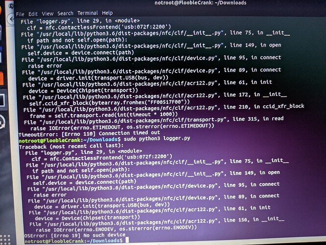

We hit a snag though. There seems to be some kind of issue with nfcpy and newer revisions of the ACR-122U

This encouraged me to get my ACR122U working on my own system. I’ve found that the PCSCD service will interrupt communication between python and the reader. I had to run systemctl mask pcscd.service to keep it from randomly starting up and borking my script.
on a side note the guide I found said to install pcsc-lite from source which subsequently prevented firefox from running correctly. It is really only useful for testing to see if the reader works.
As usual! ^^
Yeah, had to do the same here, but then it borks up my other readers (i.e. I need to manually start them, and that does bork up the ACR122U).
I’ve just given up on that reader for Linux. or most things with enforced PCSCD stuff. =/
That error seems similar to one I used to encounter even on older revisions.
repeatedly calling the ACR to do stuff over short intervals seemed to always lead it to time out after a while (and not recover even restarting the script).
I tried many things but the best results I had were from AUR’s version of nfcpy wich goes down the pyserial route instead.
But even then ACR122U was still flaky, so I switched to a Teensyduino connected to an Adafruit’s PN532 and got much happier.
