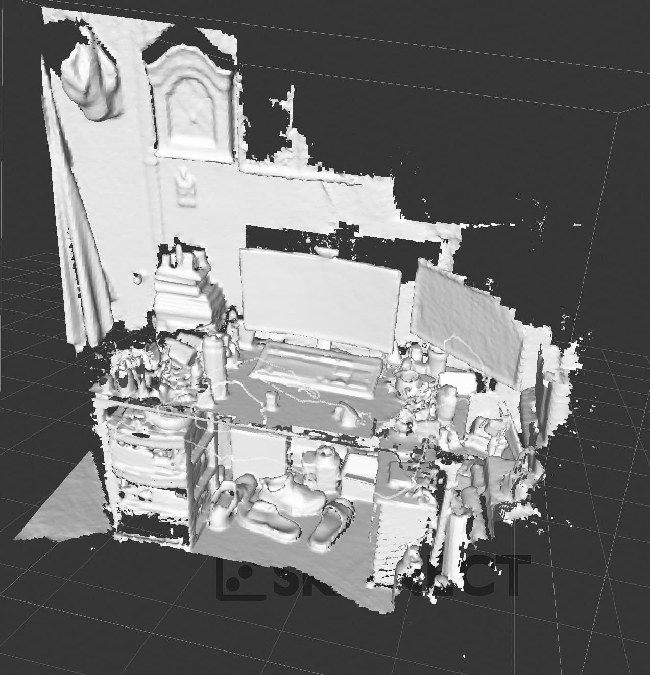

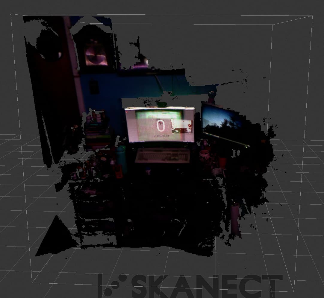

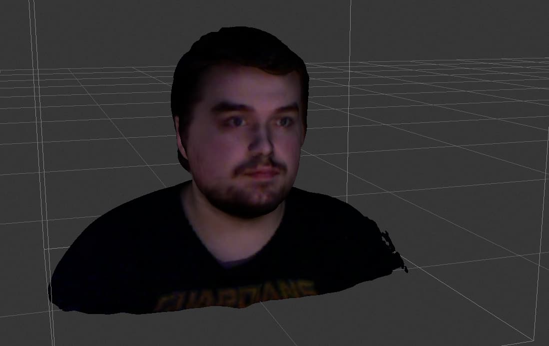

What did you use to scan your head?
I used an Xbox Kinect (the 360 kinect) years ago, using some special software. It was probably like 2017? 2016?
You can adapt a kinect on PC, by chopping off the special connector, exposing 5 wires. You wire 4 of them to standard USB, and two to a 12 volt supply (you share the ground). However, I did a really shoddy job of doing this, and right after taking that head scan, 12 volts shorted to the 5v lines. Killed half of the USB ports on that old motherboard, as well as killing the kinect itself.
I have another kinect I picked up at a garage sale, and tried to adapt that as well, but couldn’t get it to work. Thinking the kinect itself might also be dead. Need to take another look at it and see if I can get it working this time, I found it recently.
Pro-tip: the software is called Skanect. It costs a good amount of money, but if you just search Skanect + names of random colleges, you may or may not find an ā€œalternativeā€ way of using the software :wink:
You can get Xbox 360 kinects on ebay for like $10-12.
I redid all of the wiring, got it working! Hopefully did a better job wiring this time, so I don’t have another short…
Excited to do more scanning!
EDIT: Did a scan of a chunk of my desk, seems to have worked well.
Final head scan :slight_smile:
Took ages to get one I was happy with. The side of my shoulder messed up a little, but that’s a pretty minor error in the grand scheme of things.
I did this with my Kinect years and years ago… never found a fun use for it though. Gotta dig it out of a box somewhere.
It’s a shame how little things have come in the last 10 years. The hardware of the Kinect v1 is capable of a ton, but software never caught up, especially on the open source end. libfreenect is neat, and has some stuff to play around with, but nothing useful.
On the proprietary windows end, Skanect itself is barely updated, despite being a paid product, and the company has pivoted to using newer scanners of their own brand. Microsoft has their 3D Scan tool, but it only supports the Kinect v2 from the Xbox One.
I might eventually give in and buy a different scanner with modern software, or build a photogrammetry rig.
The problem is, even once you have a quality scan, regardless of solution, manipulating it into something useful is still a PITA. It feels like there are two sides of 3D model design. The CAD side, for functional parts, and the art side. Taking something in a loose 3D model, with a ton of imperfections, and using it in a CAD workflow, seems nearly impossible without a ton of work. There has been a ton of times where I would want to match the contour of something in a scan, but it doesn’t seem like that’s easy to do. I used to use Meshmixer for that kind of thing, but it hasn’t been updated in 5 years, and it feels like nothing has taken over that slack for manually editing meshes.
In pretty much all cases, it’s better just to manually measure and make a part in proper CAD software, even if the fit isn’t absolutely perfect to certain contours.
I’m hoping someone like Bambu Lab makes a 3D scanner as well. The hardware is there, and has been there since the first Kinect, but the software needs so much work.
