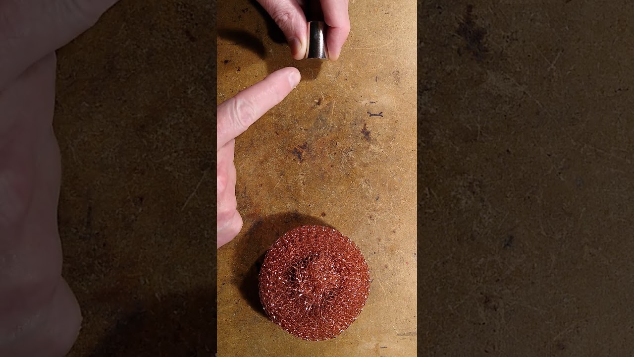

How do you clean your Soldering iron?

Just avoid steel wool as it’ll wear out the iron layer on your soldering iron tips. Use brass or a wet cellulose sponge.
brass wool works the best for me, and i clean it religiously. I cheaped out recently and picked up a copper scrubby thing for the kitchen and it is just not nearly as effective.

I’m a big fan of brass wool. Used a wet sponge for a few years. The wet sponge works fine for most things, but if I accidentally get a bit of plastic debris or something on my iron, the brass wool takes it right off. It’s also annoying to have to wet it if I’m just doing a quick soldering job, esp since I used to store my soldering iron setup in a drawer.
I bought one years ago and still works great.
I use the wet sponge between points / pads when I’m working, and then finish up with long hold on the wet sponge followed by a final brass wool scrub. The brass wool is an absolute necessity though when you forget and leave your iron on overnight and come back to a fully oxidized tip. A nice dip into flux and a rigorous deep dive into brass wool will usually clean that right up again.
i had the wet sponge absolutely destroy a fine tip for my ts100 a year or so ago and ive completely abandoned it for the brass/copper scrub
