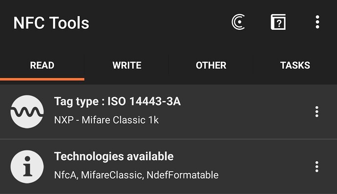

Scanned the keyfob for my new apartment:
Yay! Now I need to learn how to clone mifare cards, I’ve put that on the back burner for too long lol
Nothing like the threat of being locked out of your own apartment to motivate you to learn a new thing.
Pretty awesome luck for you

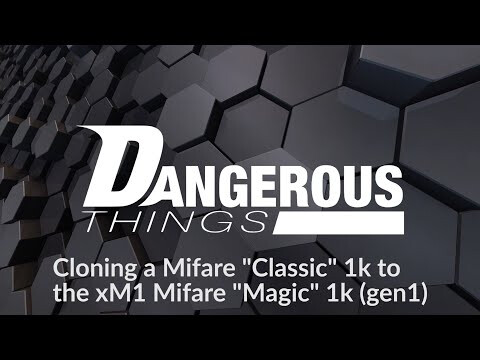

What are you going to write to, and what are you going to use to write with?
Well shit. I used MCT and cloned my xMagic, went to try it and found out the reader won’t work with an xseries. Used the HF LED keychain and nothing, diag card lights up no problem. Forgot about my flexMT, loaded up the dump file, tried to read the flex, but nothing! Used PM3, nothing! Oh well. Guess I’ll have to save up for another flex and a trip back to Texas to see Pineapple again.
MCT will only write to Gen2, not a gen1a like is in the xMagic and FlexMT
It will look like it was successful, but it won’t work.

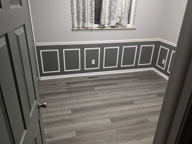

How do you measure 1/8" or 1/16"?
1.5mm and 3mm
Those are some very fine tolerances for building a house :house:
Trim Carpentry is a pain in the ass.
