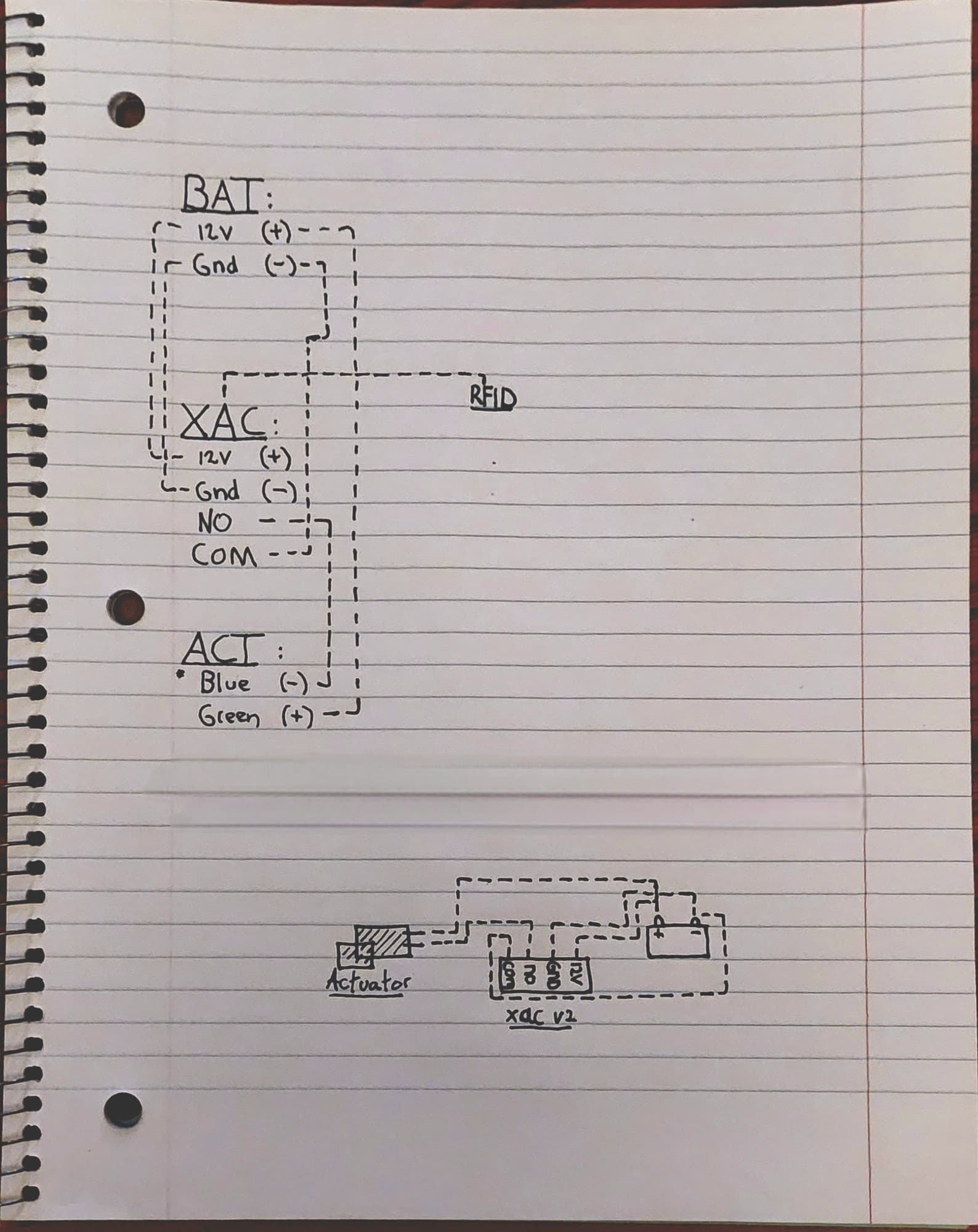

Iāve been kinda busy these past days, but in terms of notes and in terms of worth sharing, these notes were my scribbles while I waited for the XAC to arrive and guessing, learning from others etc. Turned out fairly accurate, for guess work and plenty of do-overs. Iāll get around to properly writing down/sharing pics otherwise one of these days ^^
If youāve never used ChatGPT, it was incredibly useful in correcting as well. I do pay monthly, donāt know if that makes a difference, Iāve heard some say it does. Shared the link to the XAC, the actuator on Amazon and by now she knows what car I drive etc, whatever other information could be useful for her to help.
I would suggest swapping it so the comm is connected to positive and the connecting the NO to the positive on the ACT, so that the xAC board breaks the positive feed.
My reasoning is if I wanted to bypass the switch, it would just be necessary to short between the ACT and the xAC on your original diagram. I know this isnāt being used to control a lock or something, which is why I always break the positive line on any wiring I do, but I think it a good habit because even on something like this, a short can cause the device to power on and remain on.
Huh, good to know! Iāve still gotta go back in and properly size my wires, think Iāve currently got enough wire to go front to back of the car. It started raining⦠![]()
What youāre saying sounds like it makes sense, so when I properly tuck everything up, Iāll go ahead and switch em up! Thanks!
