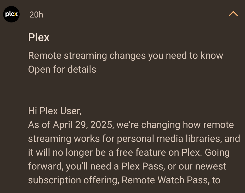

Charging you to stream your own media from your own connection. The sheer balls… but we all knew it was coming at some point. Frankly I’m glad. This means projects like Jellyfin are just going to get that much more attention and development.
