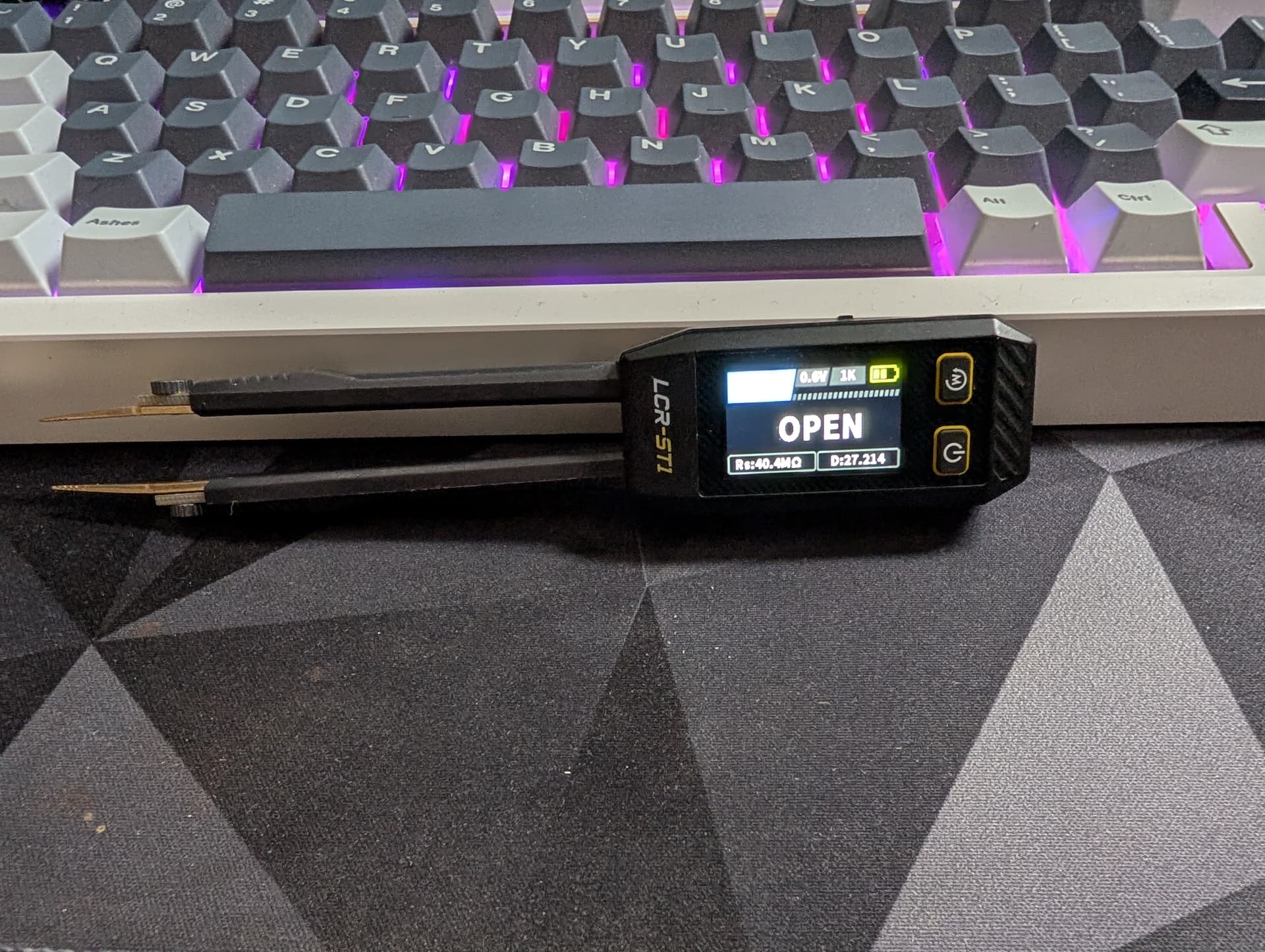

LCR Tweezers - LCR-ST1 by Fnrsi. These are great and i used them almost daily as i had to find exact values of small SMD capacitors when building a client based repeater. This is also when i realized how relaxed some manufacturers are with their +/- tolerances of certain caps.

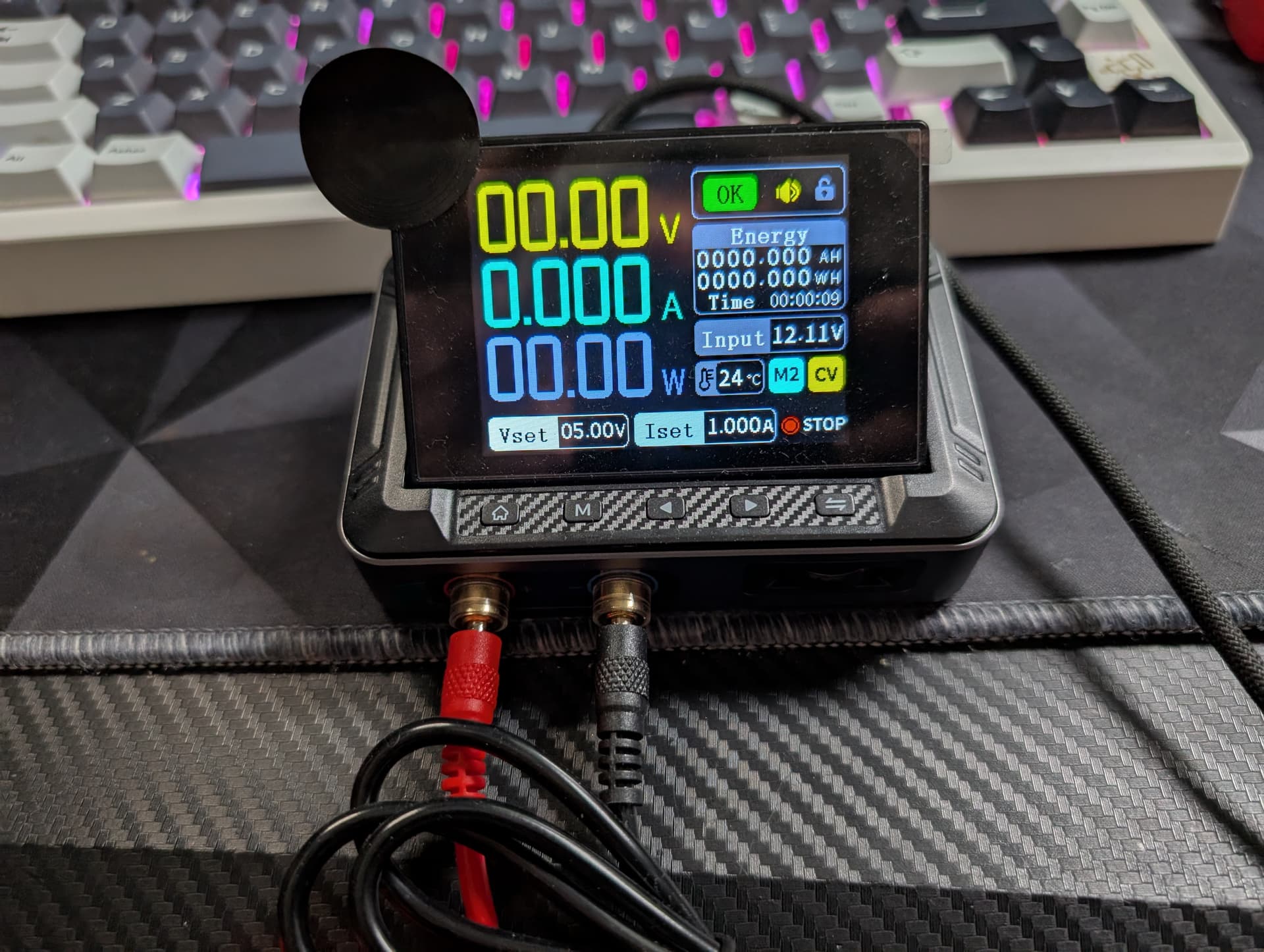

Benchtop Power Supply - DPS-150 by Fnirsi. I use this to tune my Field meters. I can deliever clean constant power to devices using a USB-PD supply to the power supply. Its great and i use it frequently without any issues.

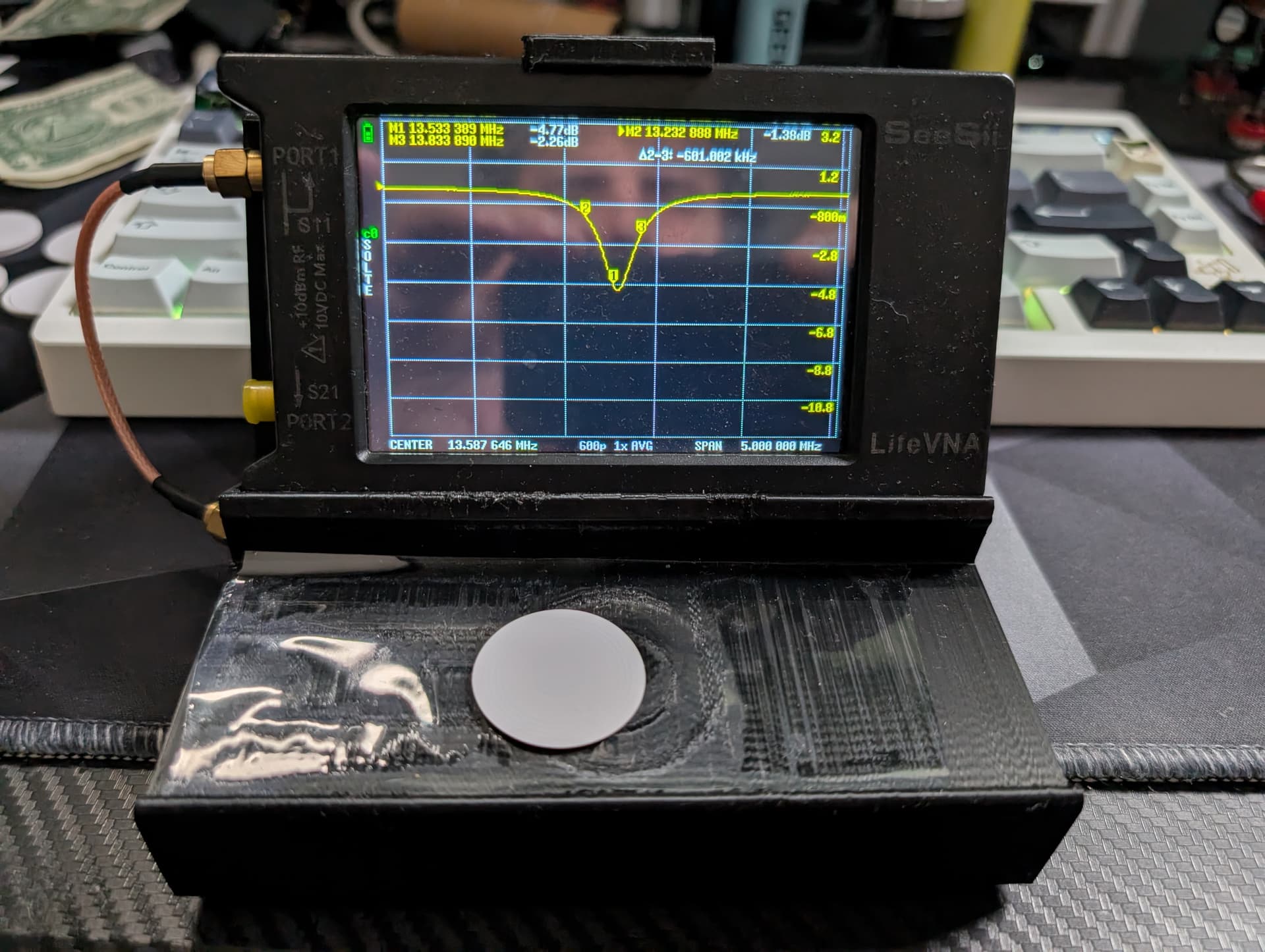

Litevna64 by Seesii - I use this amost daily. Every single repeater is QC’d with this. It is unbelievably reliable. You dont need the lite VNA, and can get by with a 2.4" NanoVna or the NanoVna-H4 by SeeSii which is twice the size for 20$ more. I cant stress enough at how useful this meter is. Ive used it to tune Meshtastic antennae, create Di-Pole antenna’s. Its seriously a 1k machine for under 100$.

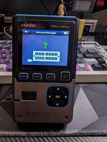

Lastly is a combined unit, the DSO-TC4 by Fnirsi. This is a Oscilliscope, Transistor Tester, Signal Generator. I dont use the signal generator or the Oscilliscope nearly as much as i should be able to, but i use a lot of different transistor testers and this one so far is the best ive used. I needed something that i can easily test regular tht components and this was the best for the cost so far.
