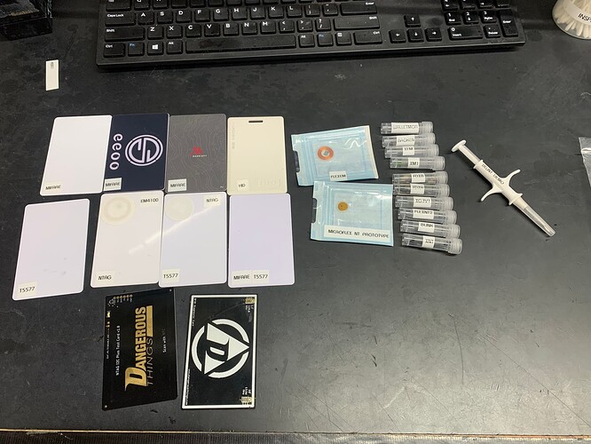

Iāve managed to get my hands on a good amount of either failed / broken / unsafe to implant tags
Maybe itās just my experience or my quirkā¦but, most people I talk to love being able to hold and look at a thing, rather than it being a picture or some ethereal thing that goes into their body they never actually see
Hereās what Iāve got so far, (I always want more
Iām taking as many types and form factors of tags as I have to help show the difference in what can and canāt be cloned, read range difference between a ISO card, a FOB, a sticker, and a glass tag

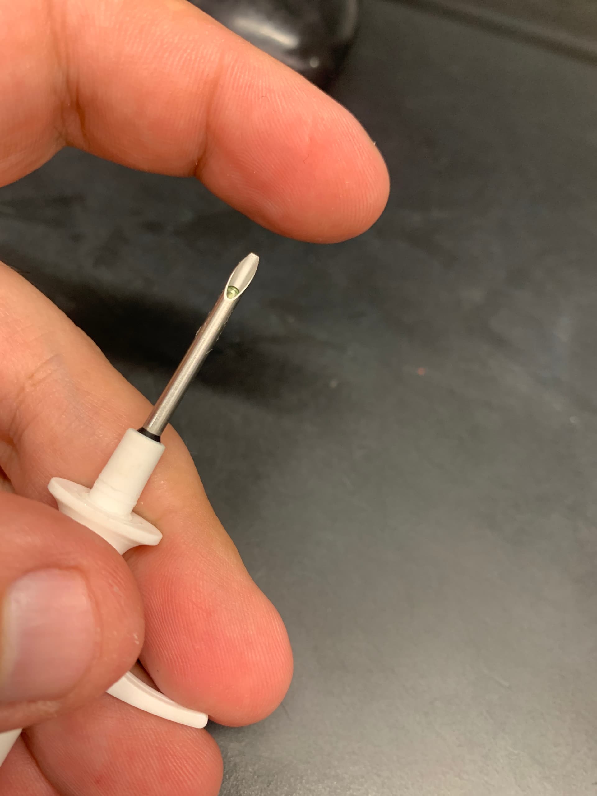

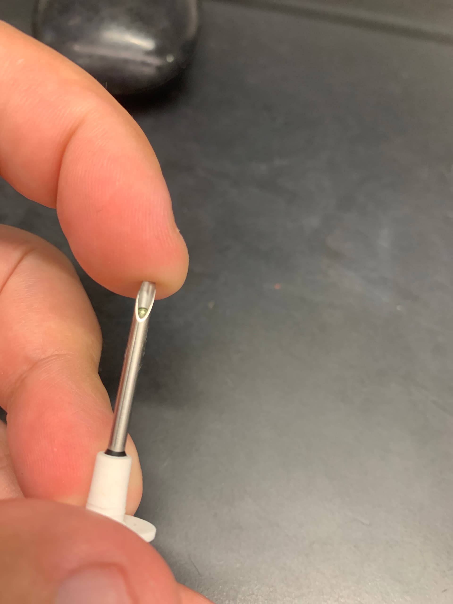

Iām also taking a injector assembly, it was used to install something into me, I kept it, cleaned it and soaked it in alcohol for a month or 2, and I recently went back through with a file and removed all the edge and point of it, and have a stand in chinessium tag loaded into it, so that it can be physically demonstrated⦠but is safe
I also have a flex needle, but it will stay inside itās travel tube, but as a explanation of how narrow flexās are more easily installed
