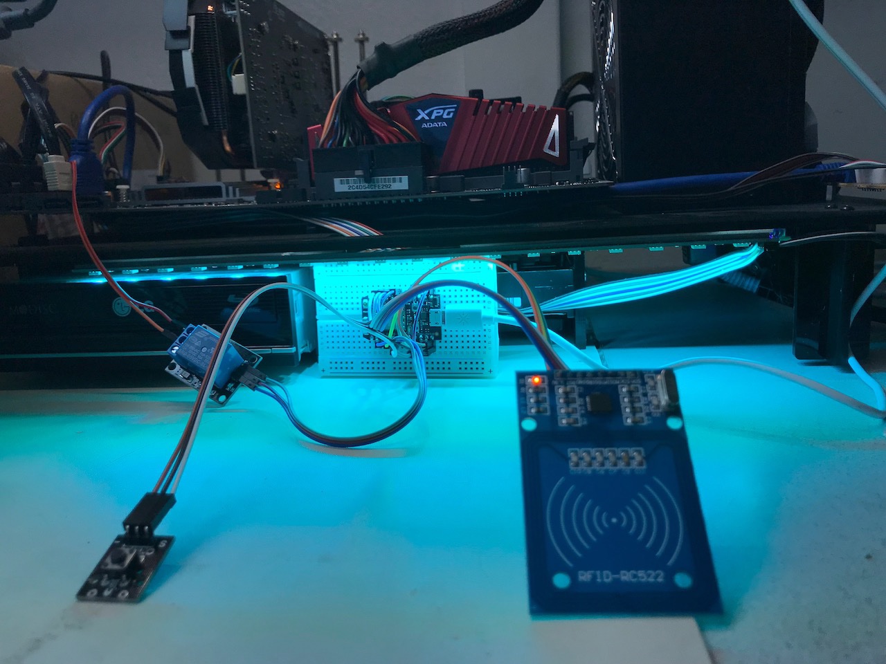

alternatively, you could turn off the password for your account (less secure) or use this as a two step authentication (more secure), you could use some form of Arduino, a relay, and a rc552 reader and wire it up to your front panel port on your motherboard. here’s some links,
