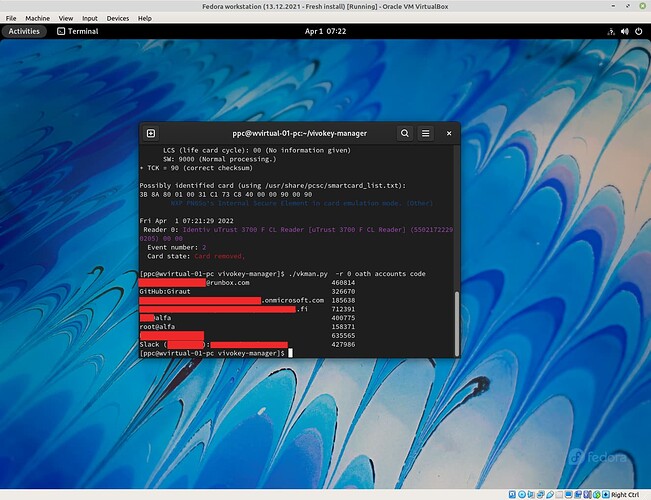

This is what I get when running ./vkman.py -r 0 info or ./vkman.py -r ACR122U oath accounts list
[ryan@ryandesktop vivokey-manager]$ ./vkman.py -r 0 info

I am running the ACR122U and I have the drivers installed as far as I recall. Also running the pcscd daemon.
If that does it for you, I’ll add something in the README. I’ll admit it’s not particularly obvious what’s going on if you’re not fairly deep into Python.
