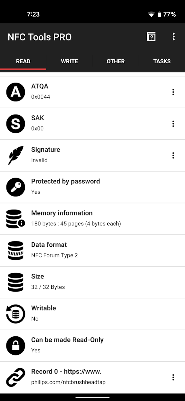

I noticed that the brush handle could recognize which brushhead was put on top. I watched a promotional video, where they stated it was NFC. Surprisingly, a quick scan revealed that it’s 13.56MHz ISO 14443a.
So…
I give you the NFC tools scan results of one of the brushheads.

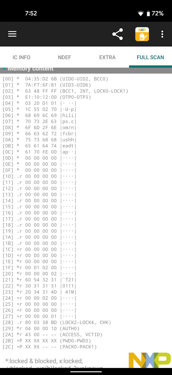

Interestingly, it appears to just be using a few bytes in user memory to store the brushhead type, if I’m not mistaken. Here’s two TagInfo dumps from two different brushheads, if anyone is interested.

You’re much more experienced with reading tag dumps, can you tell if either of them have the lock bit set for the user memory? I’d normally just attempt a write, but again, don’t want to brick it. I’m curious, if it is using user memory to increment, if you could “reset” a head to 0 uses.
