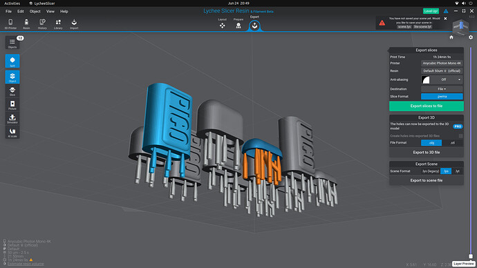

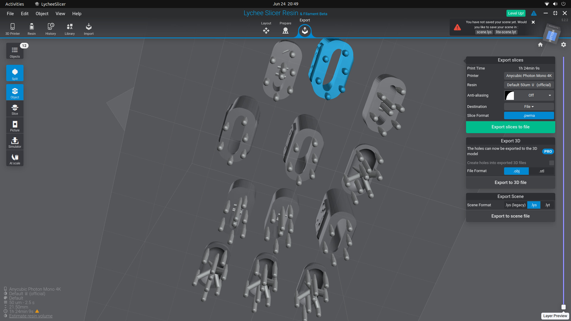

Oh that thing… I thought this was an arduino Or raspberry “pico” or something and knew nothing about it
Try to go for “light” supports
Heck post a picture of your support structure
That’s a thing too actually :slight_smile:
Heh looks like a little capacitor city
Are those medium supports or light?
I’d honestly do more, a nice ring around the outside edge to keep it from warping
Medium
They seemed to work well besides the larger piece was sitting on it’s side, not upright so the supports were on the PICO text and it made it rough. After this print is finished, I’ll try doing light supports on everything.
Yea I’d double your density and drop to light

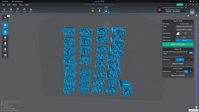

I like the lighter supports, but I did have some warping on the tinier cap piece and the lip on the body piece. I went ham with the left clicking and added more supports on all the pieces. Will give it another shot when I get back from a meet up this afternoon.
:crossed_fingers: hopefully this round of prints works out!

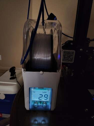

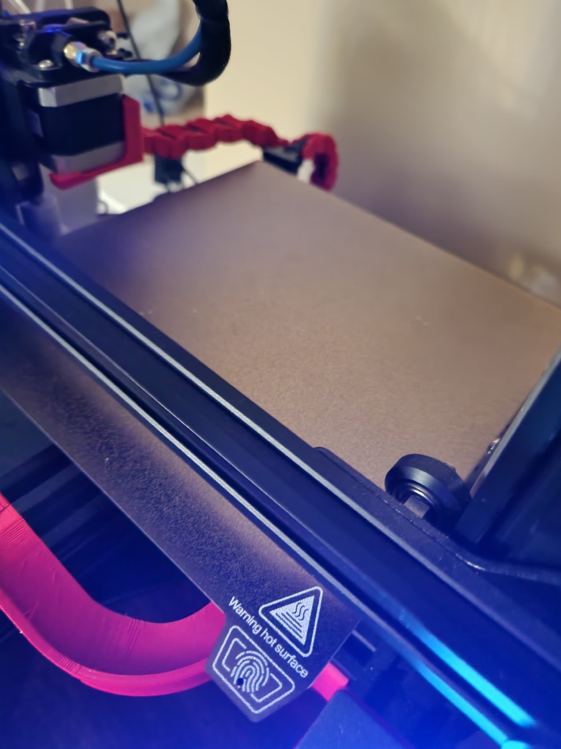

Finally got a new textured PEI spring steel bed plate for my E3Pro to replace the one that I accidentally destroyed. :sweat_smile: Also got a Sunlu Filidryer S1. Hopefully I can get some better looking PETG prints with it. Was having issues with bubbles in prints before.
Is the filament fed directly out of the dryer or do you have to setup the roll every time?
