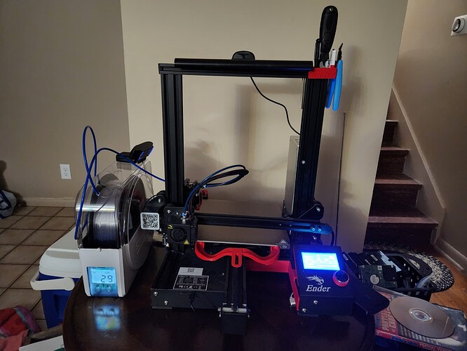

You can do either, but I have it set up to feed out of the box.

Octoprint hasn’t given me an issue this time, but I my magnetic bed for the Ender came off during a print over the night and the hot end switched to printing a case for itself while I was sleeping which was fun to deal with this morning lol
I got a camera for the Pi too. Need to look into the plugins again so I can monitor and print while I’m out of the house.
