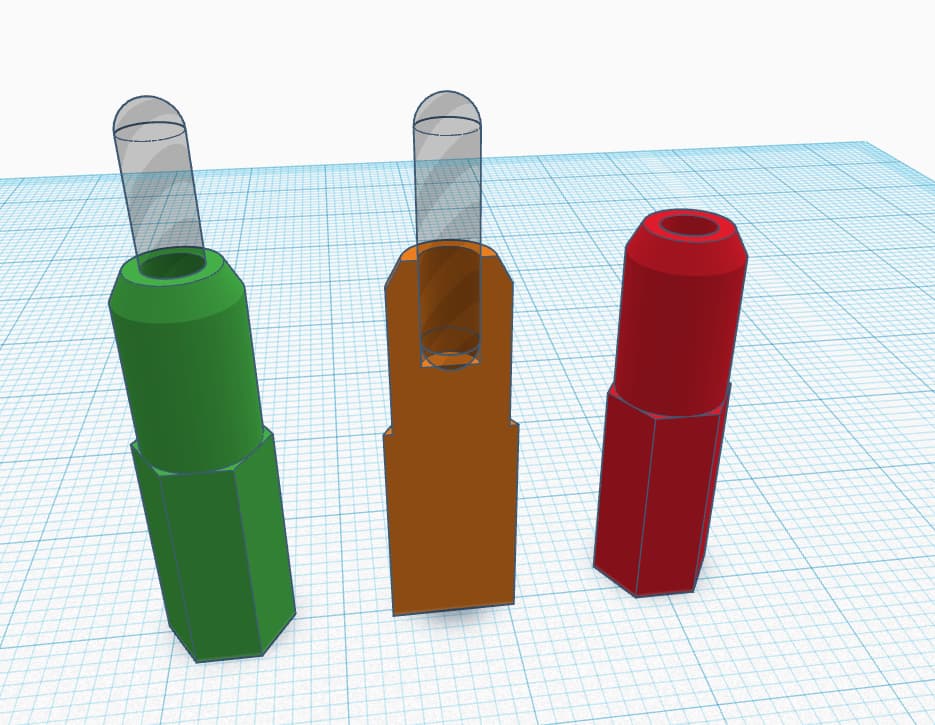

rough draft…

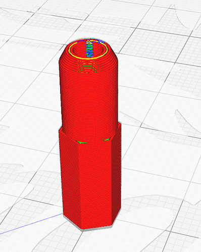

going to try for .15pu clearance see how that feels and adjust
edit .15pu too tight… I also see why that xm1 was a reject… I broke the bad seal off it :sweat_smile:
trying for .30pu clearance
edit .30pu too loose
lets split the difference and see what that do at .22pu
edit
.22pu is perfect… now I just need to make the 1\4 hex a good deal tighter
Done, might have gone .05pu too tight on the 1/4” hex… I can play with that later… but 3mm glass works good in v1 of this using petg

How’s this as a starting point?
I can make 15-20 and do some with different clearances so you can vary the fit as you like

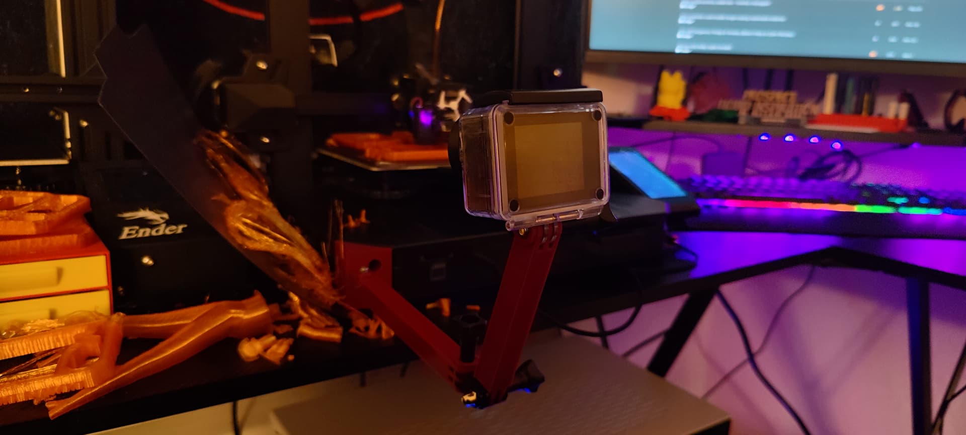

Printed a bracket for my knock off gopro so I can start doing timelapses without having a precarious stack of random shit on my desk chair to get the gopro sitting high enough XD

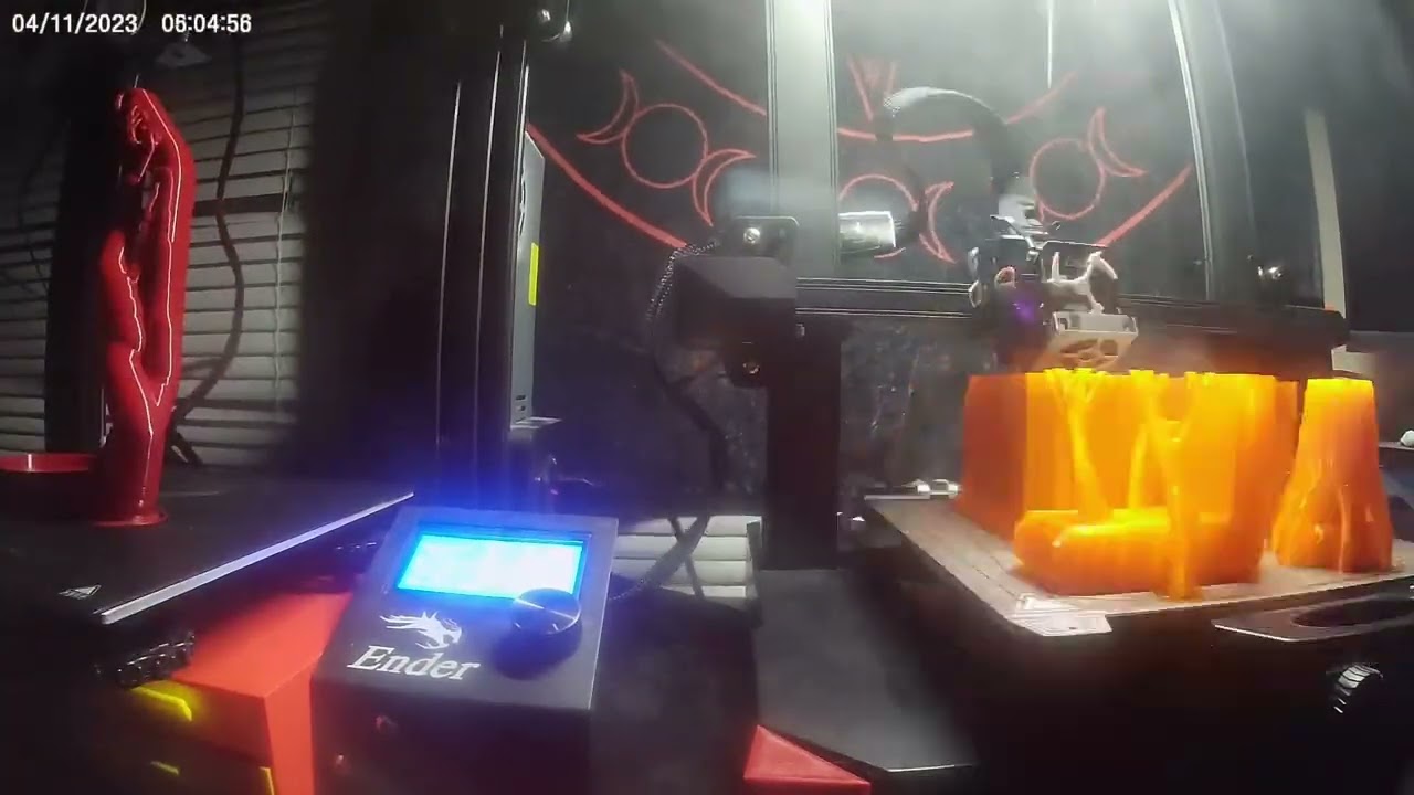

Anyone else on here do videos of their prints? I’m just starting to get into timelapses, thinking about buying a nicer camera soon and setting up pictures for every layer like the fancy vids.
Please forgive the mess, I just got back and haven’t set up the desk trash can yet XD
The E3 bed is sitting between the two printers though to keep the PETG on the right from peeling up due to the fan on the hot end of the E3 on the left.
