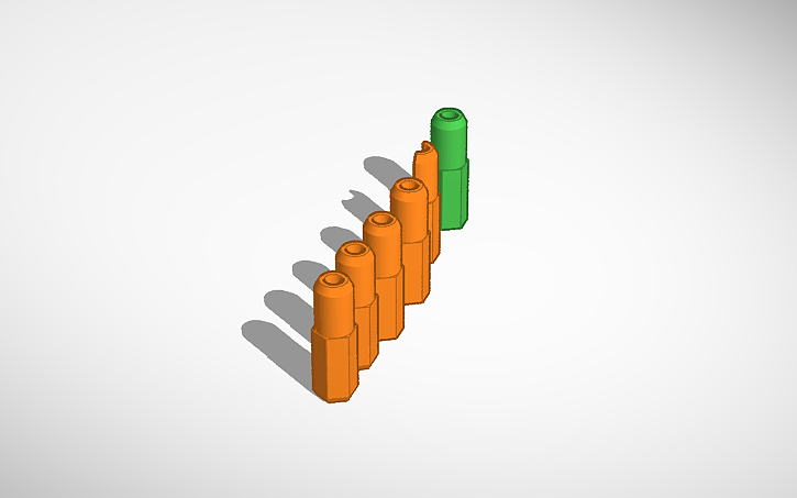

laser jig v4.stl (72.3 KB)

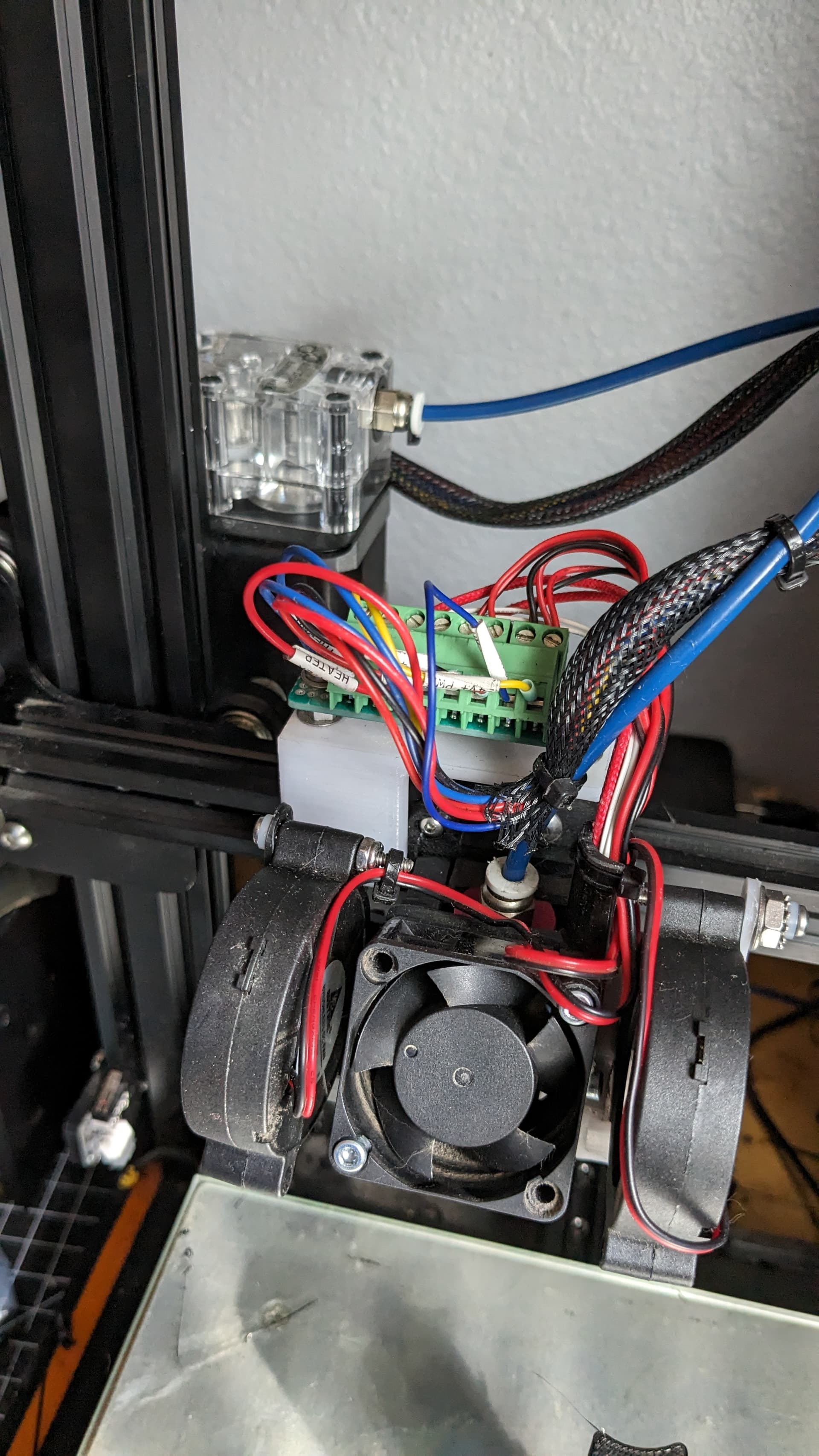

Here is the business end of things :grin:
The breakout board on top allows me to swap heater, thermistor and fans without having to re-wore everything back to the motherboard.
That looks nice! I like the clear extruder too!

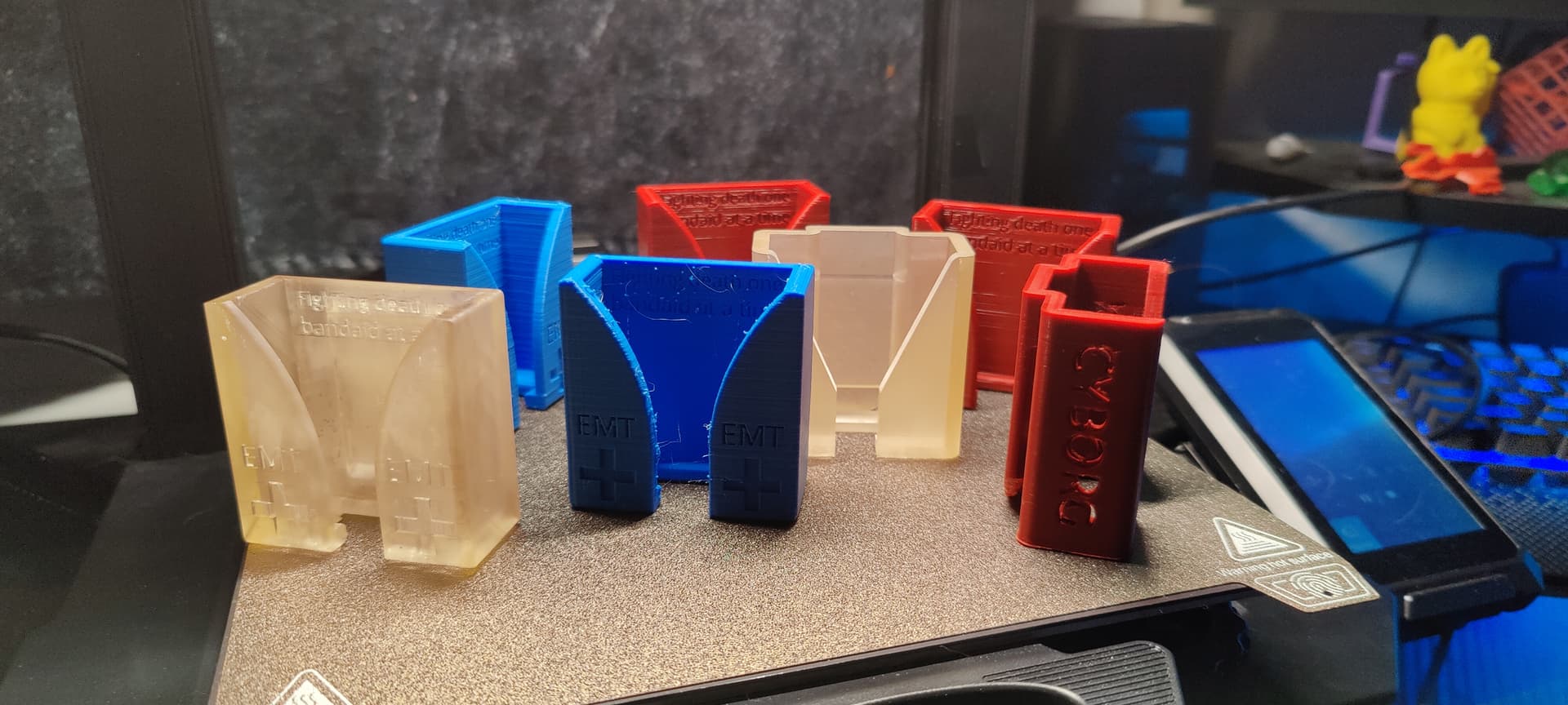

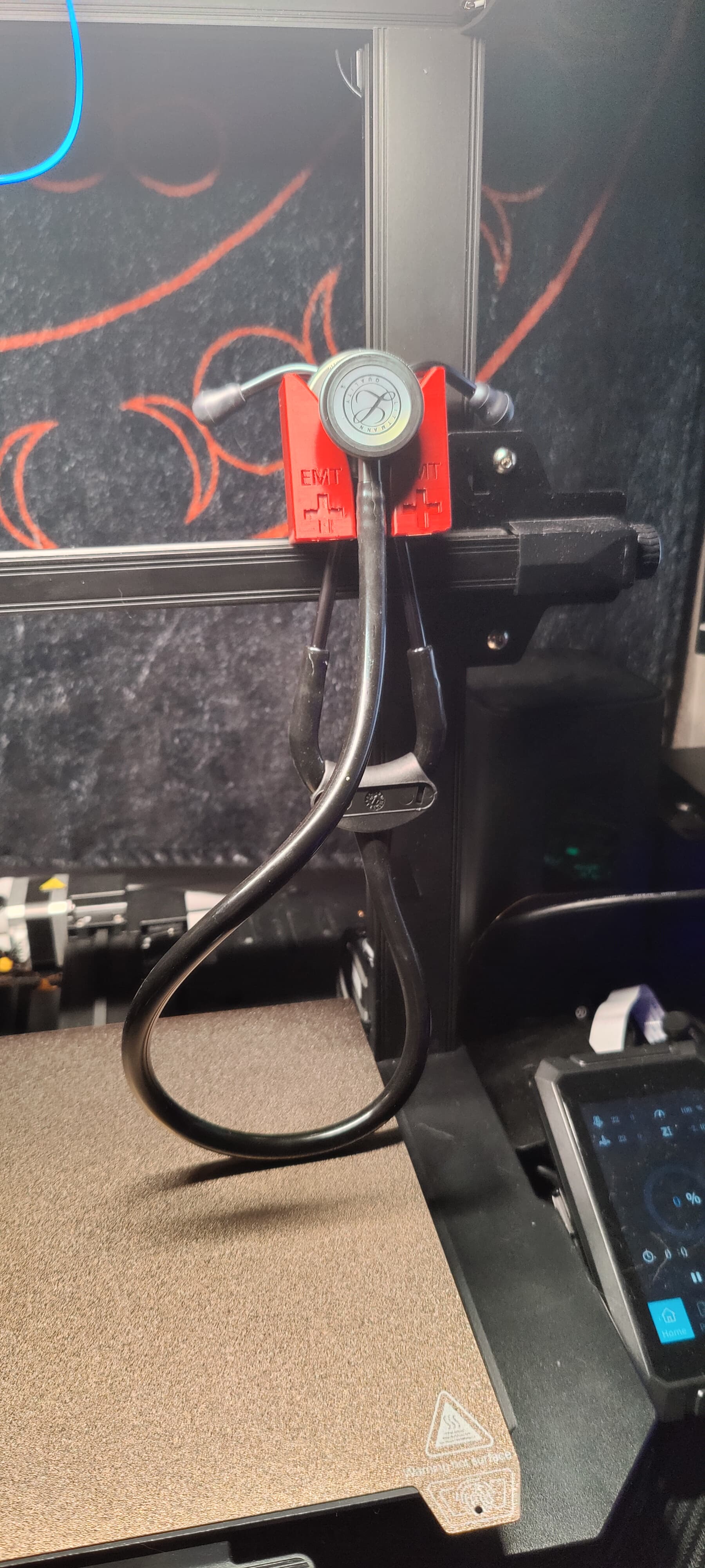

Made a stethoscope holster!
I actually made a few lol
