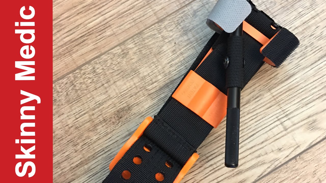

Idk if I would recommend the printed one for duty or not… but its a nice to have… I keep a spare in one incase anyone going to the range with me wants to also wear one… but I wear mine in one of these high viz orange
Amazon.com definitely duty grade
That’s awesome ![]()
Definitely! No cheapo Amazon lookalike!
I watched Prep Medic’s TQ reviews and test video, and Skinny Medic’s video, and I think one other.

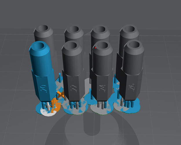

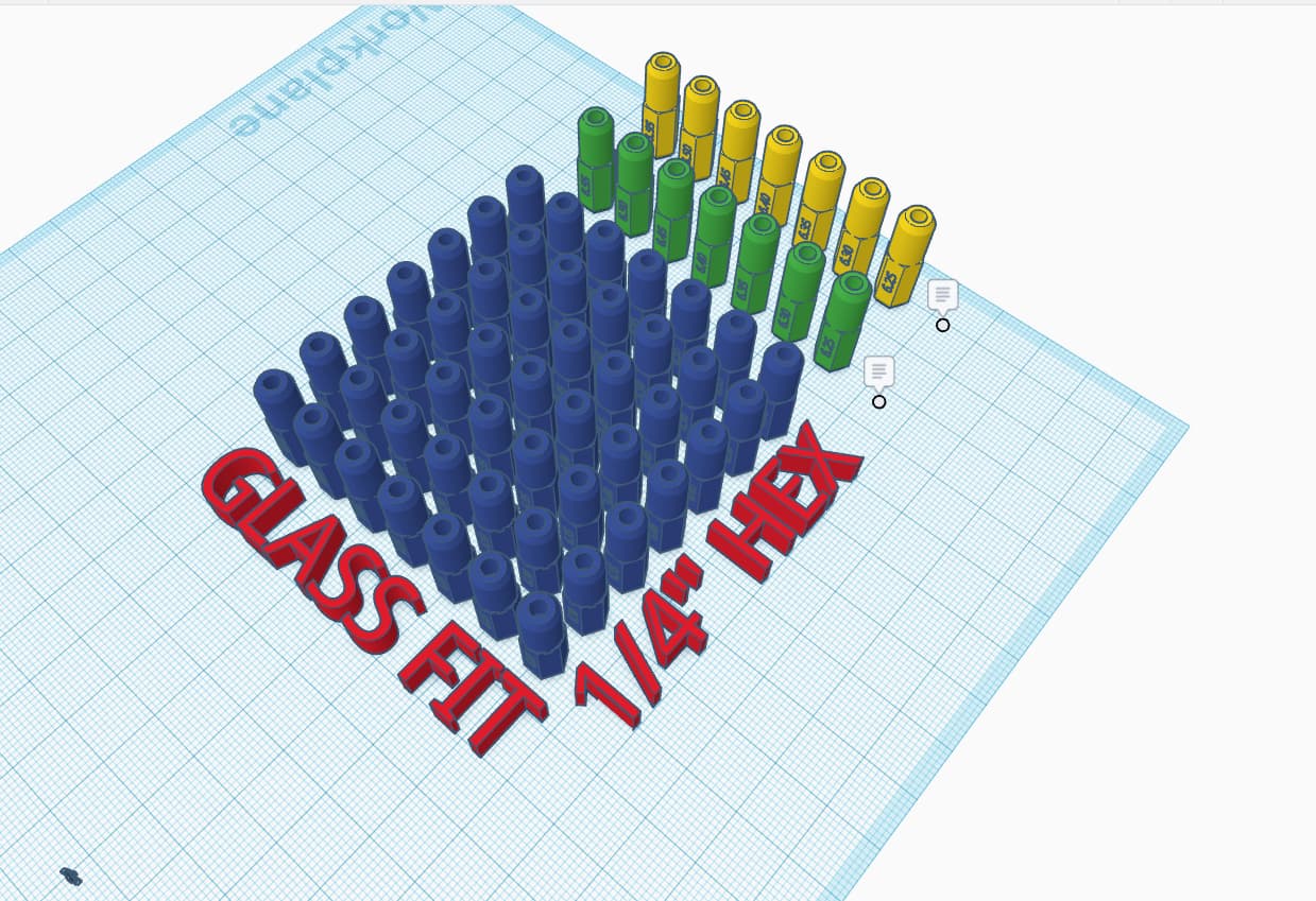

I’ll update the design later tonight, basically 5-6 of each hole clearance, and 5-6 of each hex clearance
All labeled in the part itself for easy fine tuning

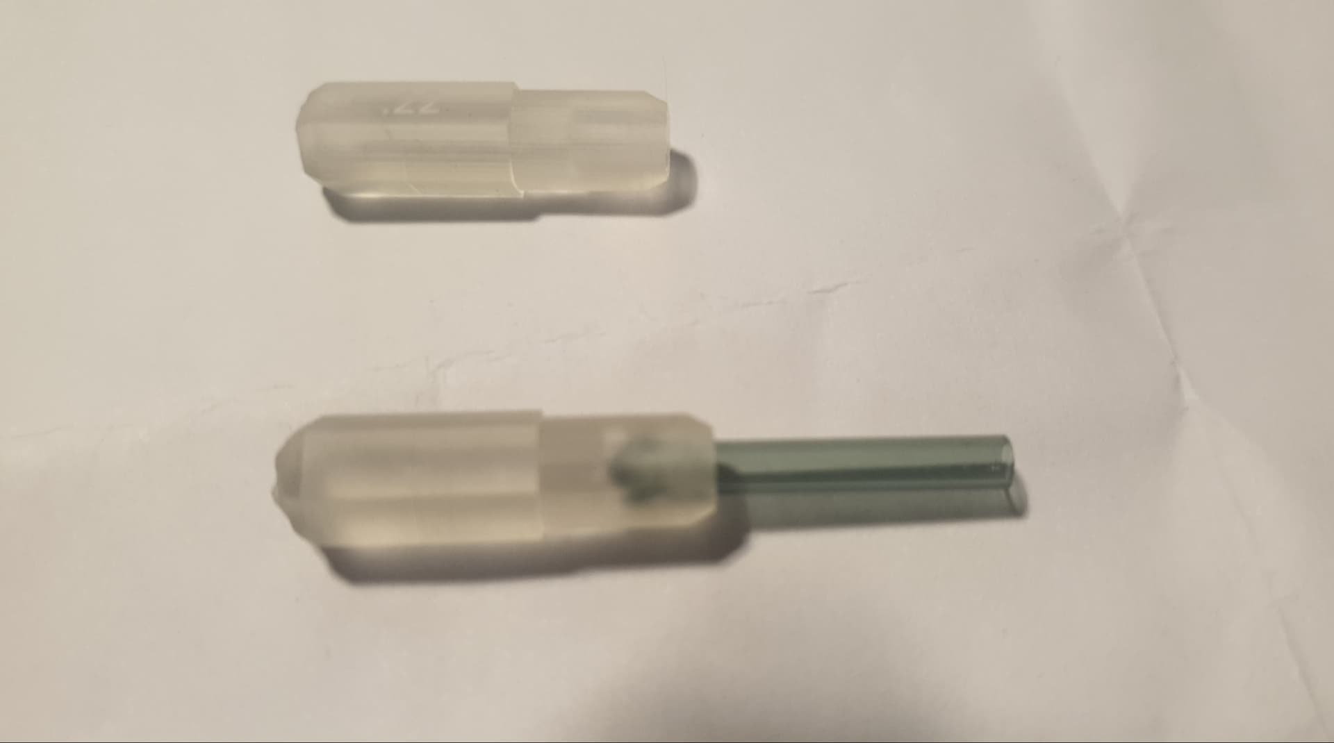

Is it possible to make the hole deeper so there is Mord contact surface between the glass and the Print?
I think that will reduce wiggeling of the glass and secure it more firmly
That’s easy … I kept it short because I was trying to keep some distance from the focal point, bla bla thermal insulation bla bla
How much deeper you want it?
I’d say 6mm depth should be ok

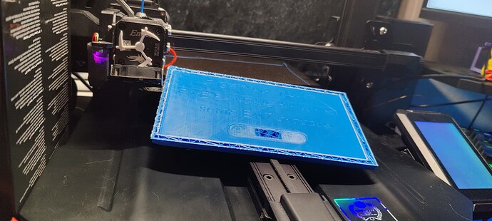

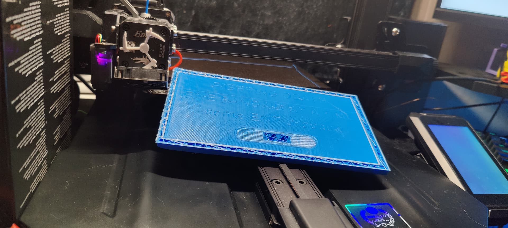

7.5 hours into a 9 hour print and it failed ![]()

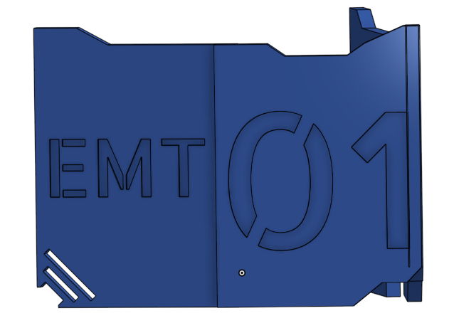

I did learn some more tools in OnShape during those 7.5 hours of wasted time though! I saw an Etsy listing for a futuristic looking half mask that was supposed to protect your face mask during the beginning of the pandemic but haven’t been able to find it since the middle of the pandemic. So I started working on my own version lol
Going to be part of my Halloween costume this year lol

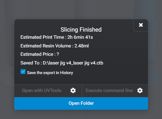

ok @mrln I created a full tolerance matrix in tinkercad, so once you figure out what 2 sizes you want, its already generated, because scaling will mess with both at the same time
but I’ll load 2 files
1 - so you can print the full test width
2 - same thing but with 9mm instead of 6mm deep holes so you can compare to see if there’s a difference for your use
bonus… since its resin 14 parts print in the same time as 1
double tolerance range 6mm deep.stl (1.1 MB)
double tolerance range 9mm deep.stl (1.1 MB)

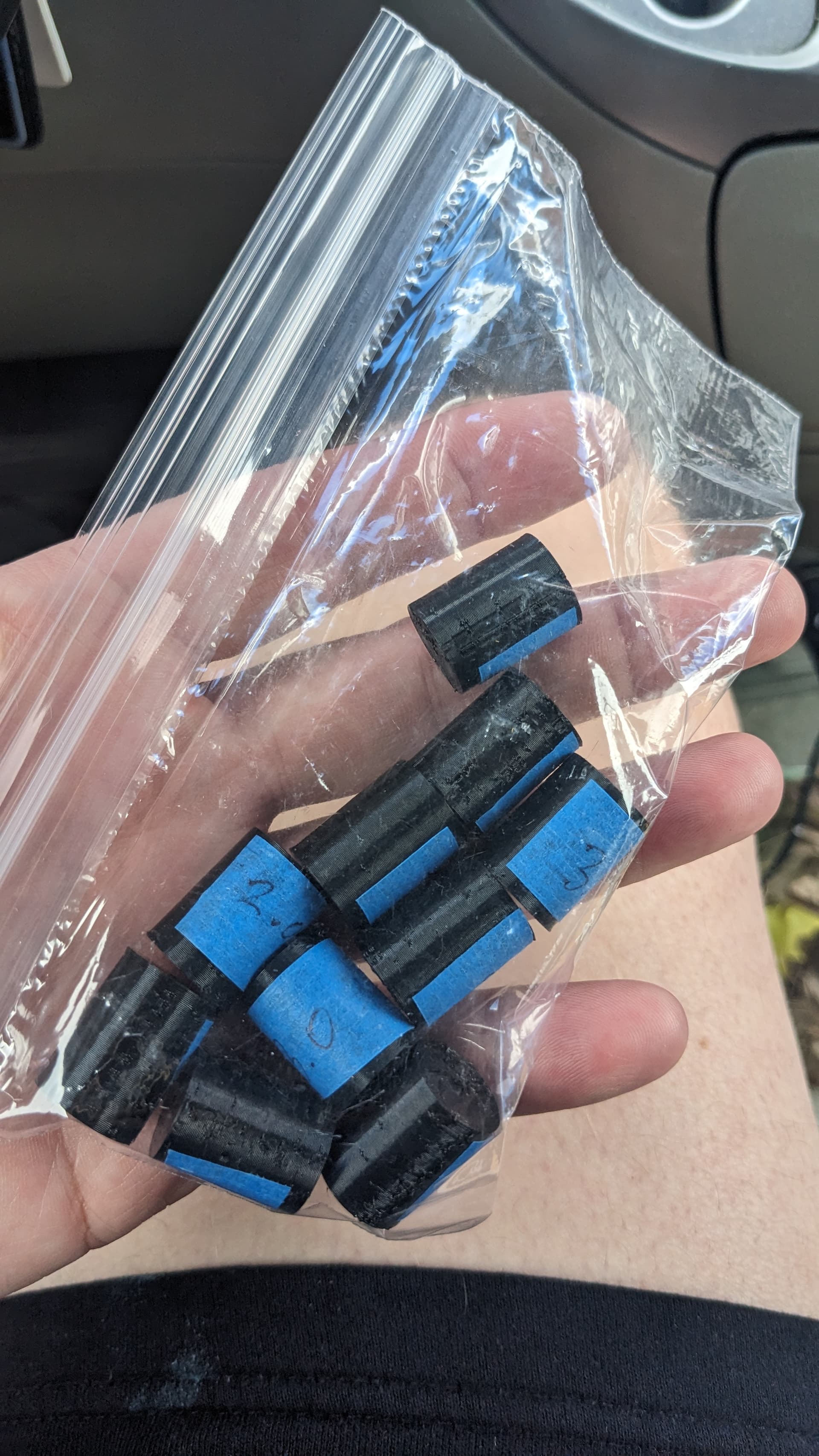

@amal, are you in a rush for these?
I figure what I can do is print the same 7 pieces that spans the range, and send you that… you tell me what size you like and Ill make and send you some of that in petg

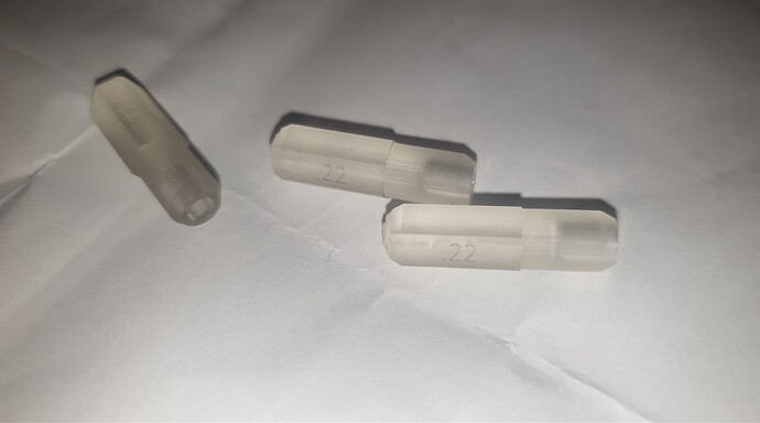

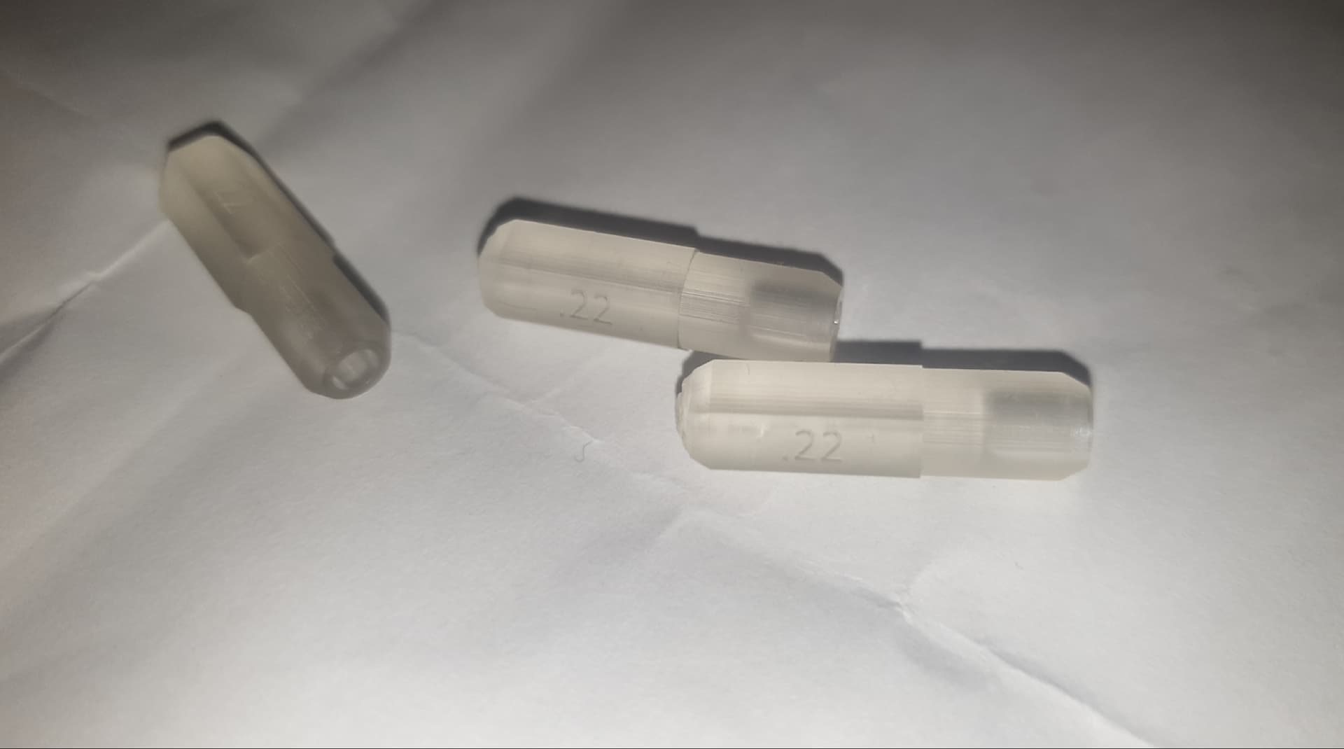

Im printing both depths but only going up to .26 tolerance to save some resin (my resin stock is low so i need to save every bit i can until the new is delivered)

Woot! Got some prints… gonna test tonight and update the DT Club laser thread for fit.
