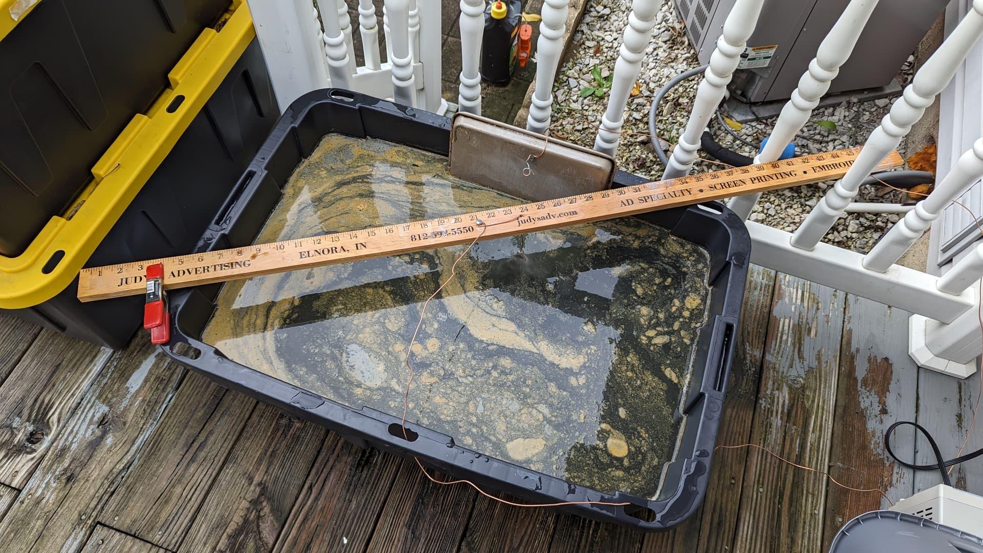

Put together an electrolysis tank for restoring cast iron pans! Removes carbon buildup, old seasoning, and rust.
Running it off of my adjustable power supply, running at 12 volts, pulling about 5 amps.
Electrolyte is sodium carbonate (washing soda, annoying to find), and my sacrificial anode is an old steel baking tray.
Trying it out with a small skillet first as a test, but working well. After less than half an hour, a lot of the carbon buildup is gone already.
Should take about an hour and a half per pan.

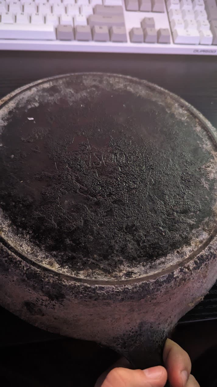

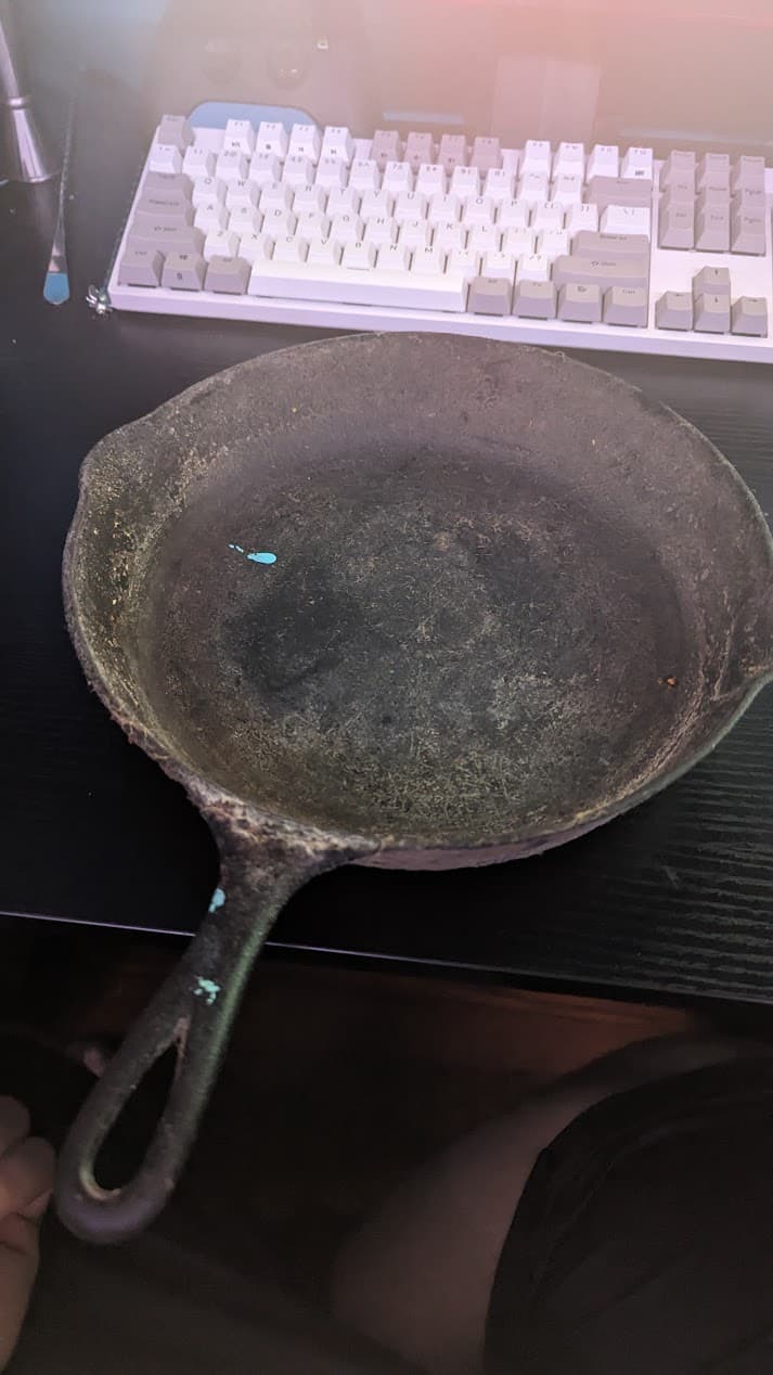

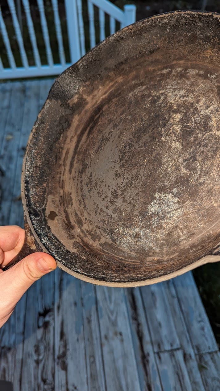

For some background, my great aunt gave me a skillet that belonged to my great grandmother and likely my great great grandmother before that. It was made from 1906-1916, somewhere in that range (can identify it based on the logo and text). Well over 100 years old.
Absolutely disgusting. Super dirty, tons of caked on carbon (can barely see the Griswold logo), and even some paint splatter. Been hanging in the kitchen for the better part of two decades (my great grandma died in the early 2000s). The outside was covered in spiderwebs and dust so thick that it didn’t wipe off, and was super rocky from the carbon.

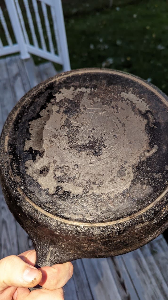

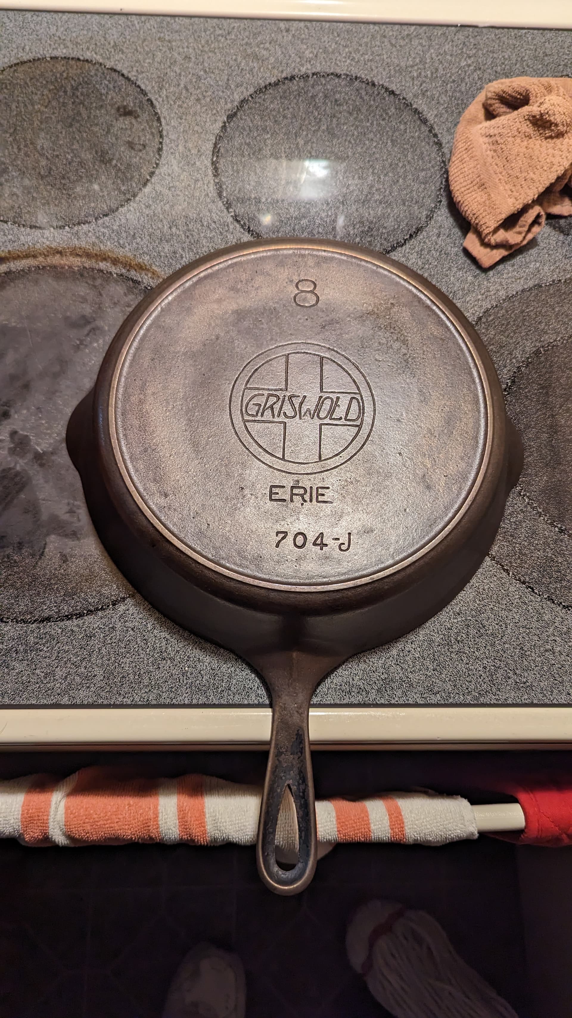

This is after about an hour in the e-tank, and a little bit of scraping. Seeing tons of bare iron now, including most of the logo.
Starting to see the cooking surface now haha. Looks like barely any pitting if any at all.
Will probably take another hour or two, maybe three, before it’s completely down to bare iron. That black carbon is so hard and thick on the outside that it’s taking a while to soften.

Electrolysis is going again. Biggest problem so far has been finding a good sacrificial anode. The baking tray I used had a coating on it, and I attempted to scrape it off, but didn’t have a clean surface. It was behaving odd overall, with the current dropping off very quickly, even after cleaning.
My dad gave me a chunk of steel a while ago for this purpose, but it was small, and covered in mill scale. It didn’t work at all.
Thankfully, my dad is a welding instructor, with a ton of steel at his disposal. He welded together a 14"x14" plate of 3/8" steel, cleaned it til it was completely shiny, and welded a nut on top to get a good connection.
Just started it up, and it’s working tremendously better. With the old baking tray, it was only drawing like 2-3 amps of current, and rapidly fell off, going down to under 2 amps. Was seeing little progress after the initial clean.
It’s now maxing out my supply, and staying at 5.1 amps (constant current mode, going down to like 10.5 volts). Seems to be way more consistent, and the oxide layer formed looks a lot cleaner. I was getting some weird green layer when I used my baking tray, despite no copper being present in the electrolyte.

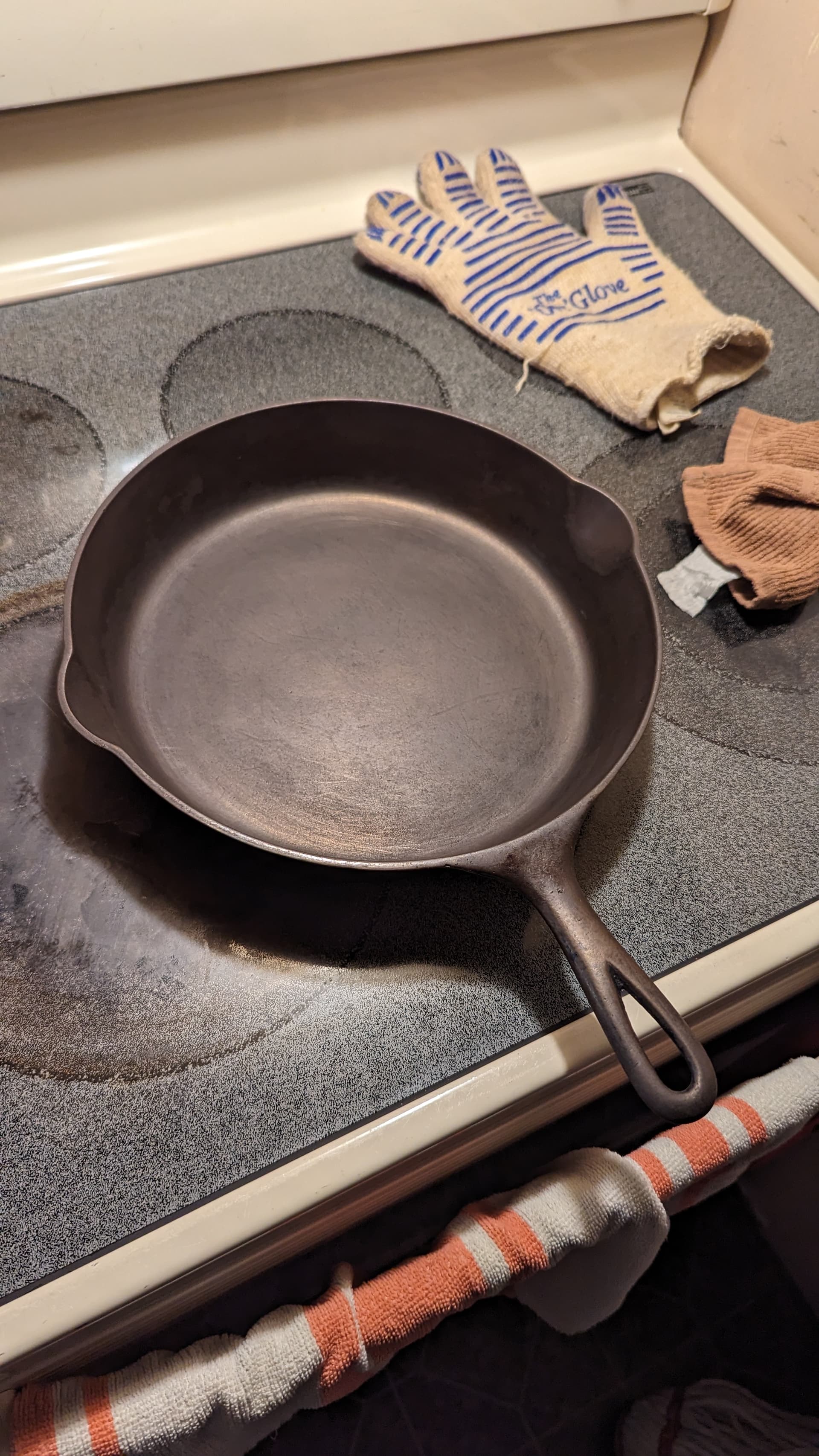

Still doing another layer of seasoning, maybe two, but have two layers on it, and it’s looking really nice :slight_smile: especially compared to before…
Can barely tell it’s the same pan.

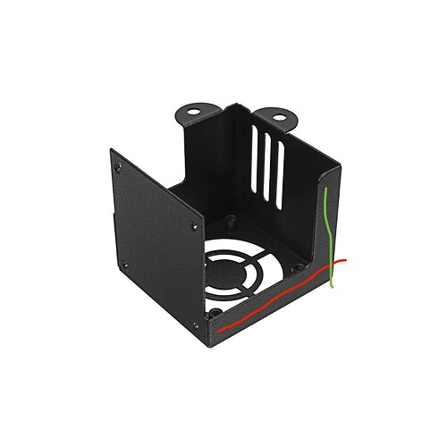

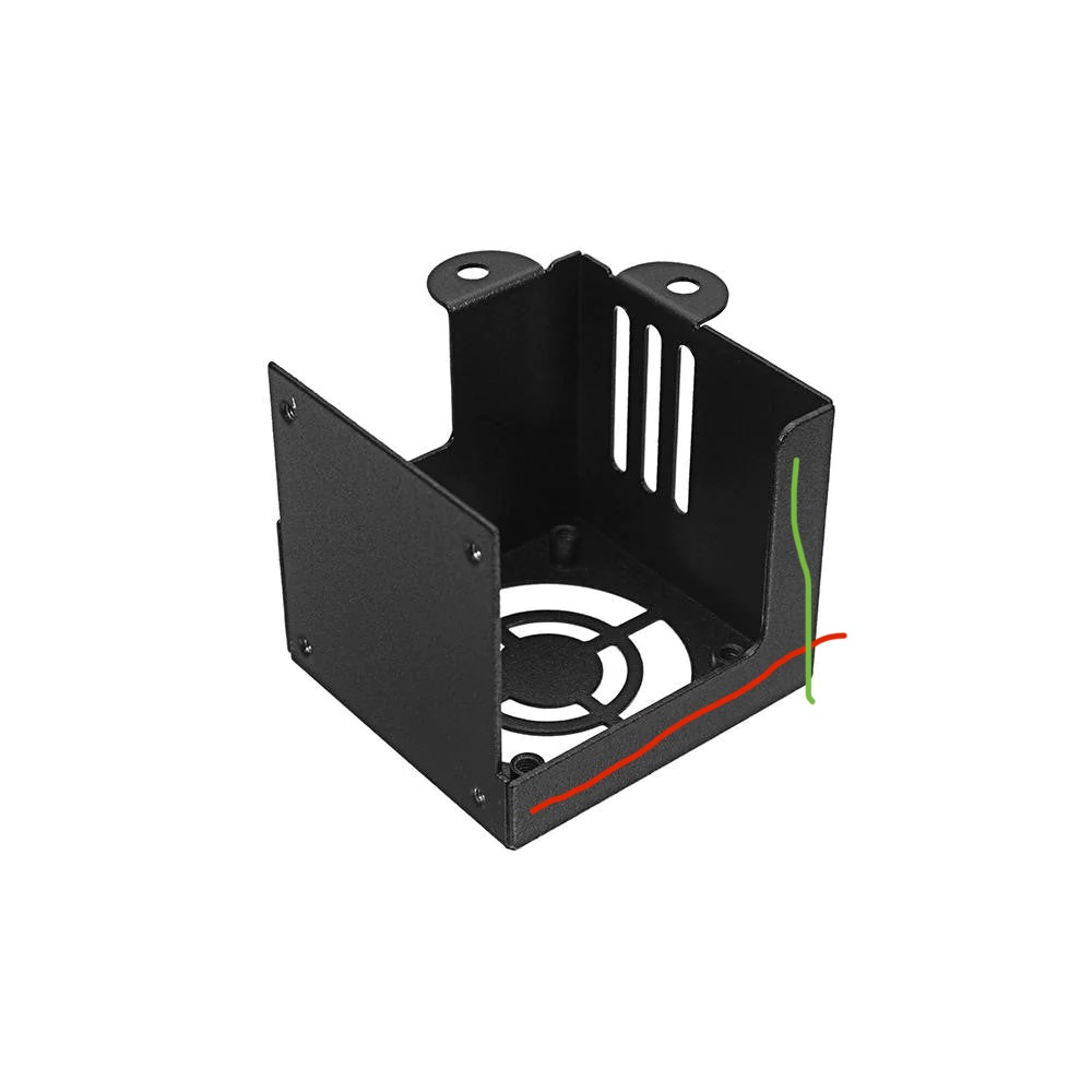

Not at home at the moment, can anyone give me a quick measurement on the standard ender 3 hot end fan shroud
Need red And green dimension

[there you go, since you expected a snark]
:wink:
Lol I wasn’t going to @ everyone with an ender but that works too lol
I many things, including various forms of constant struggle bus, but “little” is not something I’ve been called in a while lol
~48x42.5 mm
Sweet thanks,
Have some physical leds in hand and needed to match module sizes
Any chance you can get a rough measurement of the width of red and green also?
I think I have a plan, and I’ll have extra parts I can share when done
~12 and ~9 mm
Nice🤩… 8mm wide strips
Should be able to do a strip on both green and red sides
