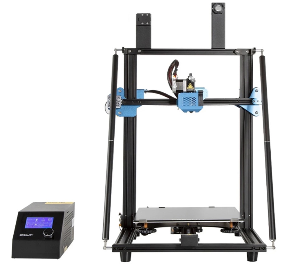

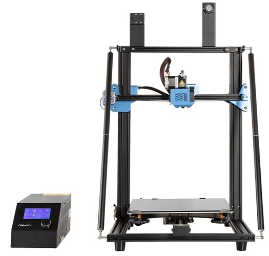

I resisted buying a filament printer for years because I don’t have time/resources/interest to endlessly tinker. Two years ago I felt the field had started producing true plug’n’play machines and bought a Creality CR-10 V3 E3D. It was a breeze to set up and printed a few of those sample tugboats perfectly. On about the 4th print the feed gear on the hot end exploded. I think I fed in some poor quality filament which didn’t melt and the knurled filament feed strained to push it into the hot end until it bust a gut.
It was such a disappointment after finally deciding to jump in that I just abandoned it. But now I have a couple of projects that filament would be better suited for. So…
Do any of you know what is the least amount of parts I would need to replace to get it back up and running?
I don’t want to start over from scratch: the machine is “new” and unused.
Ok, that’s a 24v version of the CR-10.
The extruder on my Ender 3 also did that, several times… I tried a metal version but ended up with a cheap bontech clone. But I’d start by taking it apart, cleaning the filament residue, and setting the tension towards the lower side of the scale. You should also check the hotend as clogs cause extruder problems.
I’m way too tired but look if it has an all metal of PTFE lined hotend. All metal is less likely to clogg in my experience. Sometimes you get a gap between nozzle and PFTE lining that fills with plastic and this creates a messy clogg.
Also, once you get the extruder and hotend side of things working, get a CR-Touch. It helps a lot.
Insomnia kicked in so here’s what I found about the extruder on the CR-10 v3; it’s an E3D Titan:
That one looks like a great extruder and I almost bought one for my Ender. However, I have never used one so take this with a grain of salt.
From what I could find, the CR-10 v3 appears to come with a PTFE lined hotend. If that’s the case, you need to clean out the thing, then unscrew the nozzle by about 3/4 of a turn, seat the PTFE tube all the way in, and then tighten the nozzle.
Or you could just get an all metal heatbreak and call it a day. I have a Copperhead in my E3, it works great.
