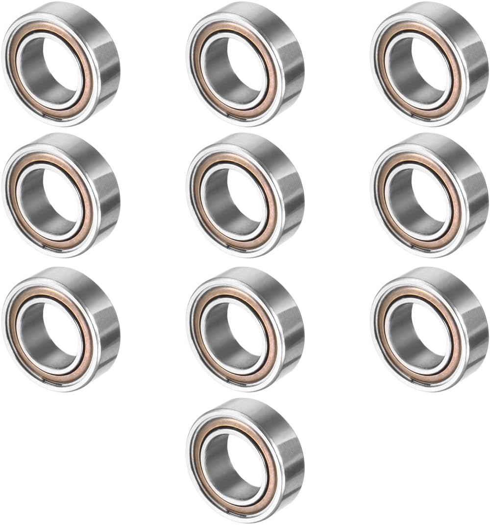

Here’s the rub: that’s the extruder that exploded! I stripped it down today and it’s only one small bearing that failed. I’m writing to them to ask if spare bearings are available.

If you can measure it (calipers?) you can match it up and replace it. Sometimes you can just pull the part number where its printed on the bearing too.
Can probably buy a bag of them off Amazon for cheap.

Great idea! The bearing exploded into lots of tiny little pieces, many of which I never found but i could measure the bits I have and search for a replacement.

e3d sell the bearings to repair the Titan for £0.65 so I’ll start there. If I find myself making a lot of prints I might splash out on some Micro Swiss machinist porn.
