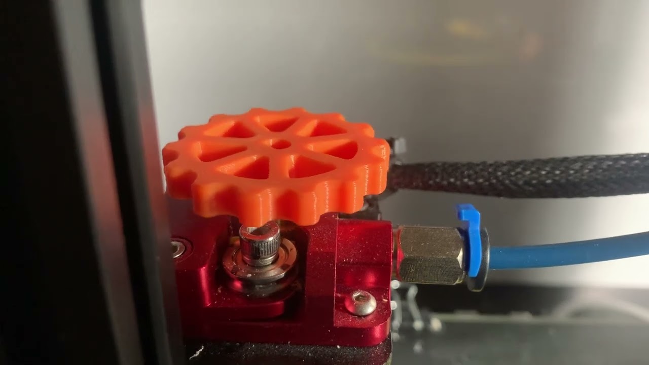

I’ve gotten even my ender 3 to spit filament back in the day…. Lemme see if I can find a video of when I was printing face shields for a local hospital using a 1mm nozzle
This was with petg also, so I couldn’t go as fast as pla would have allowed
If you have an ender you should recognize the speed of that extruder for that it is lol… my spool was constantly in motion
