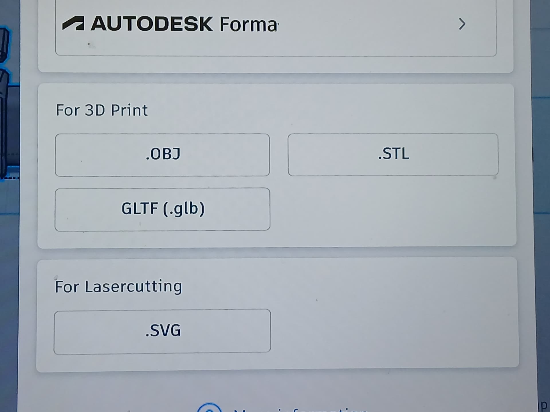

I prefer STEP when possible. It’s a standard for CAD, so it allows more flexibility if you want to edit things.
True, but it looks like @Chimpofm designed it in Tinkercad which I don’t think supports exporting as STEP
best i can do….
