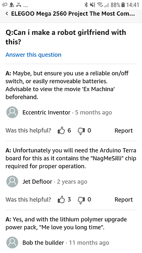

Interesting question…
I just love the Full Metal Jacket quote in the last answer :smiley:
