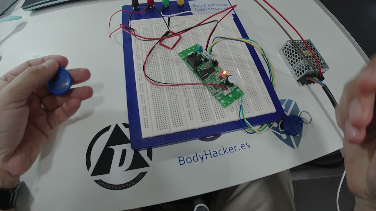

Hi so recently I purchased the lifestyle bundle and in said bundle it has NExT Chip Implant and xEM access controller. I emailed asking for help and came to a semi dead end. I was told I have the version 2 xEM access controller. I understand the 2 other implants and the magnet which is included in the bundle but I have absolutely NO idea how to power the xEM access controller so I can add an NFC card I have onto it! Obviously I want to figure this put before putting it into my hand. Can someone please help! Does absolutely everything I need come in the bundle I bought? Can someone explain it to me in dummy terms PLEASE! Thank you!

As for power it takes 9v DC to 12v DC which can be provided by a battery or a transformer. It will draw up to 102mA so almost any power supply should be big enough. You would connect the positive to red and the negative to black for power.
So do I need to buy the circuit board and power supply? I’m so confused!
So the access controller is a reader that allows you to scan a chip like the xEM or the LF side of the NExT an if it is an authorised chip then open / close an electronic switch.
It is for DIY projects etc you supply power (12v), enrol your implant, attache the output to something (in the example it’s a door latch) and when you scan the enrolled implant the door would open.
No, the board in Amal’s video is not necessary, it’s just something that’s useful when trying out various electrical setups without needing to solder
You will need a power supply, 9-12v range
I used a xACv2 in my gun safe project
The paper manual that comes with the xEM AC should tell you how to set it up initially for enrollment after you power it. It also tells you which wires are used for what
