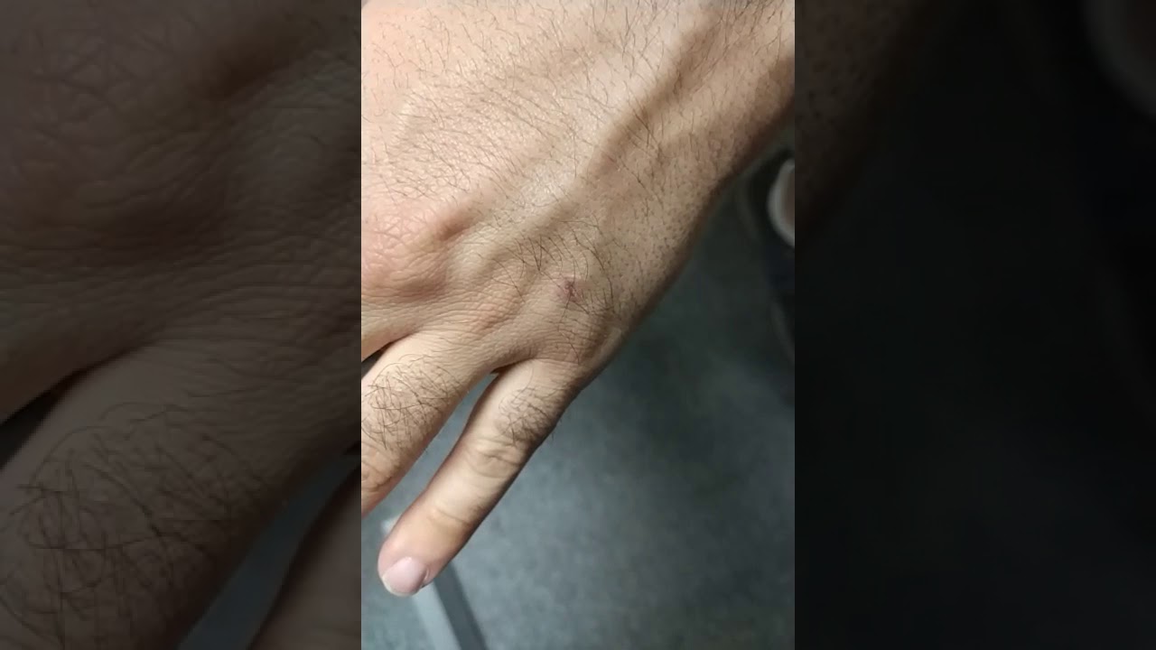

Here’s a picture of my xG3 in its current location.
Mine seems to be working great, despite its location. It is a very mild tingle when near alternating current power sources, but admittedly it’s somewhat weak.
Oddly enough I feel it just the same and sometimes better with the palm of my hand towards the power source despite the injection site being on the back of my hand. I can somewhat feel it with the back of my hand against the insulated wires, but with less definition in the sensation.
Swelling went down in a couple days and I consciously took care not to do very much with my hand for about a week.
X-Rays! Now that I see it, the xEM (on the right) looks a little close to the bone… but it hasn’t caused me any issues yet. So far this placement is working out great.
Thanks for the images! Yes both look rather close to bone, but if they are not causing you issues, then it should be ok. There is simply an increased risk of breaking if they happen to be trapped between a blunt force trauma and that bone.
