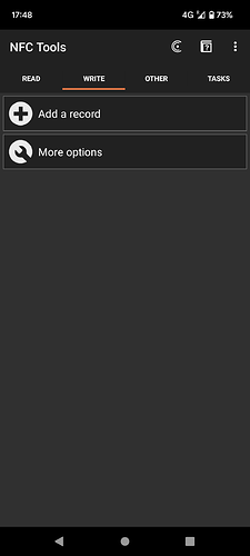

I have an xsiid blue led in my hand and just recently it stopped reading or writing with NFC tools app.
If I’m on the read page of the app, it says approach an nfc tag and when presented, my implant will light up, but the app will not respond or read.
Additionally, it is the same story with erasing (have NEVER attempted to lock the tag) or writing. No response from the app.
The last thing i attempted to do with it was write a text file to my implant.

You used “add record” right?
That’s NDEF
On tag writer they’re called datasets
Yes I used Add record, then whatever i wanted (i usually put a yt link to rick roll people) then write, approach nfc tag, and it would write.

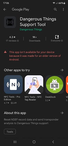

I would try using the Dangerous Things Support Tool to try to write a blank NDEF record to the xSIID;
https://play.google.com/store/apps/details?id=com.dangerousthings.support&hl=en&gl=US
Ah hell, i guess s22 ultra is too new for the support tool. I get the “this app was made for an older version of android” message.
You should still be able to open it though after seeing the message right?
Download button isnt even appearing. This is in play store
https://m.apkpure.com/dangerous-things-support-tool/com.dangerousthings.support
