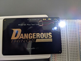

That’s why I went and figured it out. Here’s a pic of an NFC silent test card with an Apex chip in parallel. Even at 9.6MHz resonance it still reads really good :joy:
