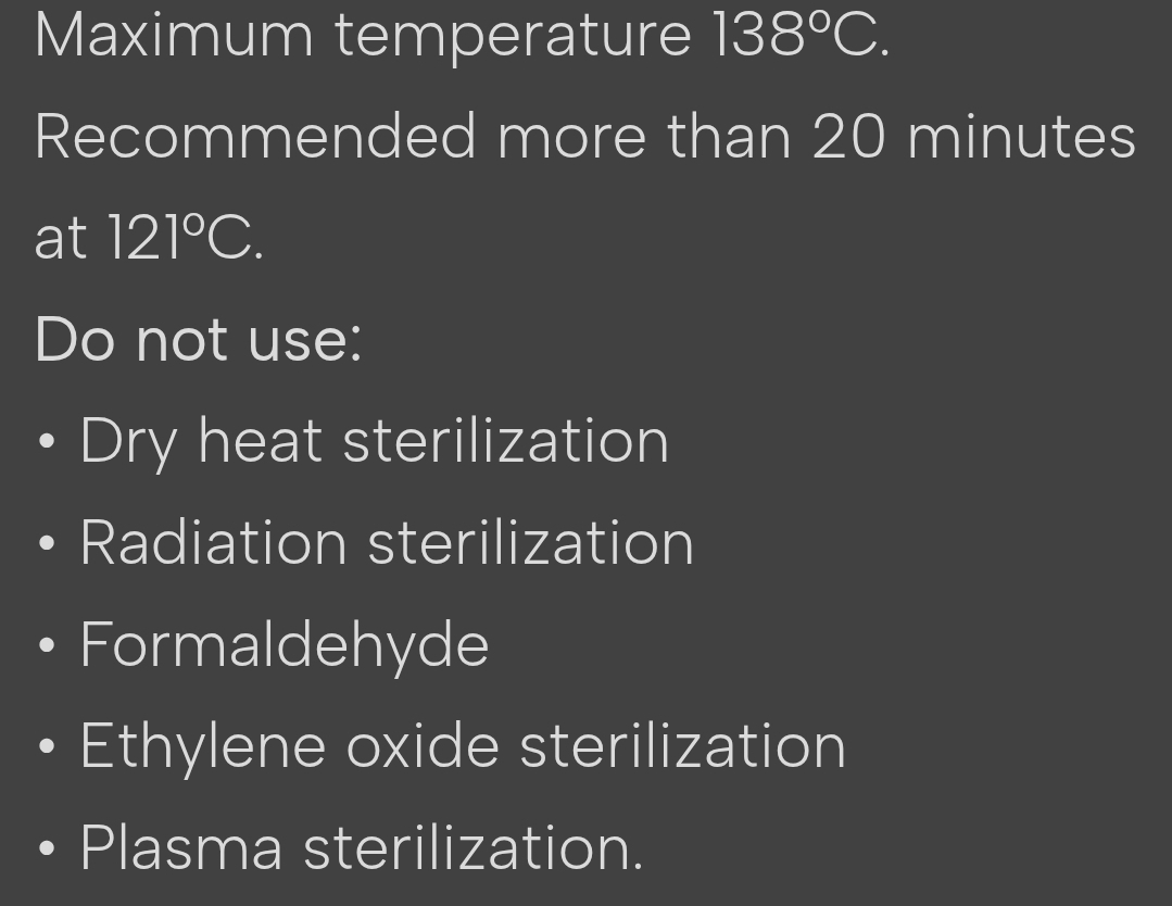

On the page, am I understanding this correctly, that it is implied that you can have the magnets run through an autoclave? I thought that was a no-no because heat.
These are not neodymium magnets. They’re a special higher temperature type. They’re not as powerful but will withstand temperatures above an autoclave. It also allows them to be laser welded in to their case, as opposed to the titan which had a magnetic blank inserted into the case, welded shut, then magnetized after (the heat from welding would damage the magnets otherwise)

Just out of curiosity, does anyone know why they’re saying not to use EO gas sterilization, is it because of humidity or does the gas react with titanium in some way?
I’m not really sure but my hunch is that the material they are coated with absorbs the gas and eo gas has a problem with residual toxin left on the devices. Normal processing requires many flush cycles to clear it completely and some material will just not let go of it very well, especially porous material. The coating on the magnet is designed to improve adhesion so it’s definitely porous.

I don’t understand this fully:
Sure, dry heat runs at 160C or higher. And radiation might not make it through the magnet well enough but please correct me on this if I’m wrong.
But low temperature plasma and EO gas should be pretty safe, right? What am I missing?

The only downside to gas plasma sterilization I am aware of is potential absorption of the sterilant, rendering sterilization ineffective. This is partially why you use a process indicator. Ineffective sterilization due to insufficient sterilant would result in an incomplete or dull transition of the process indicator. Sterilizing small numbers of magnets like one or two, even if they did have absorption issues, should still leave plenty of sterilent to do the job. I’m not sure what the reasoning here is.
It’s just copied from the manufacturers instructions I think.
Interesting. Most dental offices I know of have small EO gas systems or gas plasma, not steam. A lot of their instrumentation is not effectively sterilized by steam autoclaves. I wonder why these devices can only be sterilized by autoclaves and nothing else?
