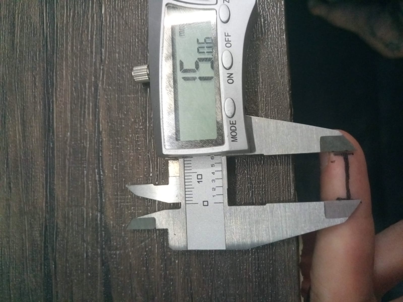

This is the length oft the magnet. Seems to fit easily… at least that’s my opinion.

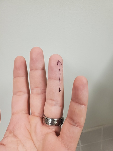

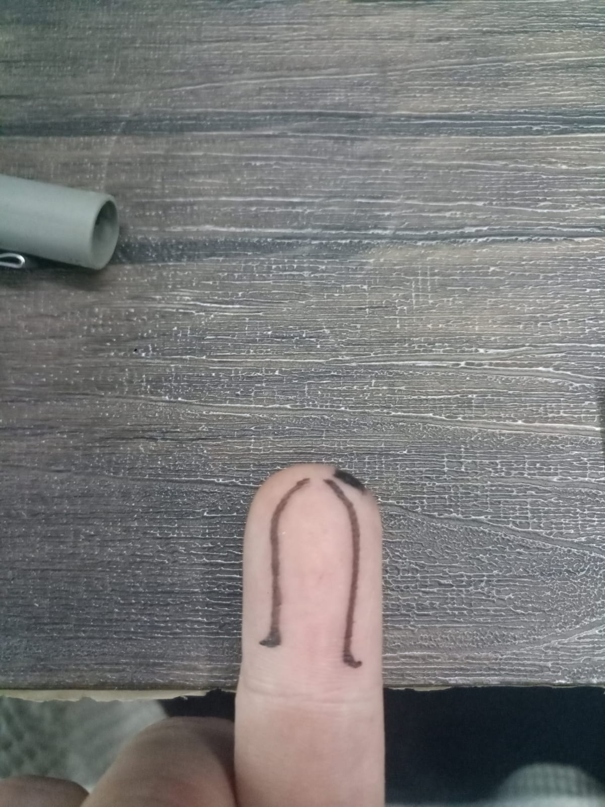

Can you mark out where you plan to insert?
The hole is at the dot at the very tip. Between the two marks it should sit in the end.

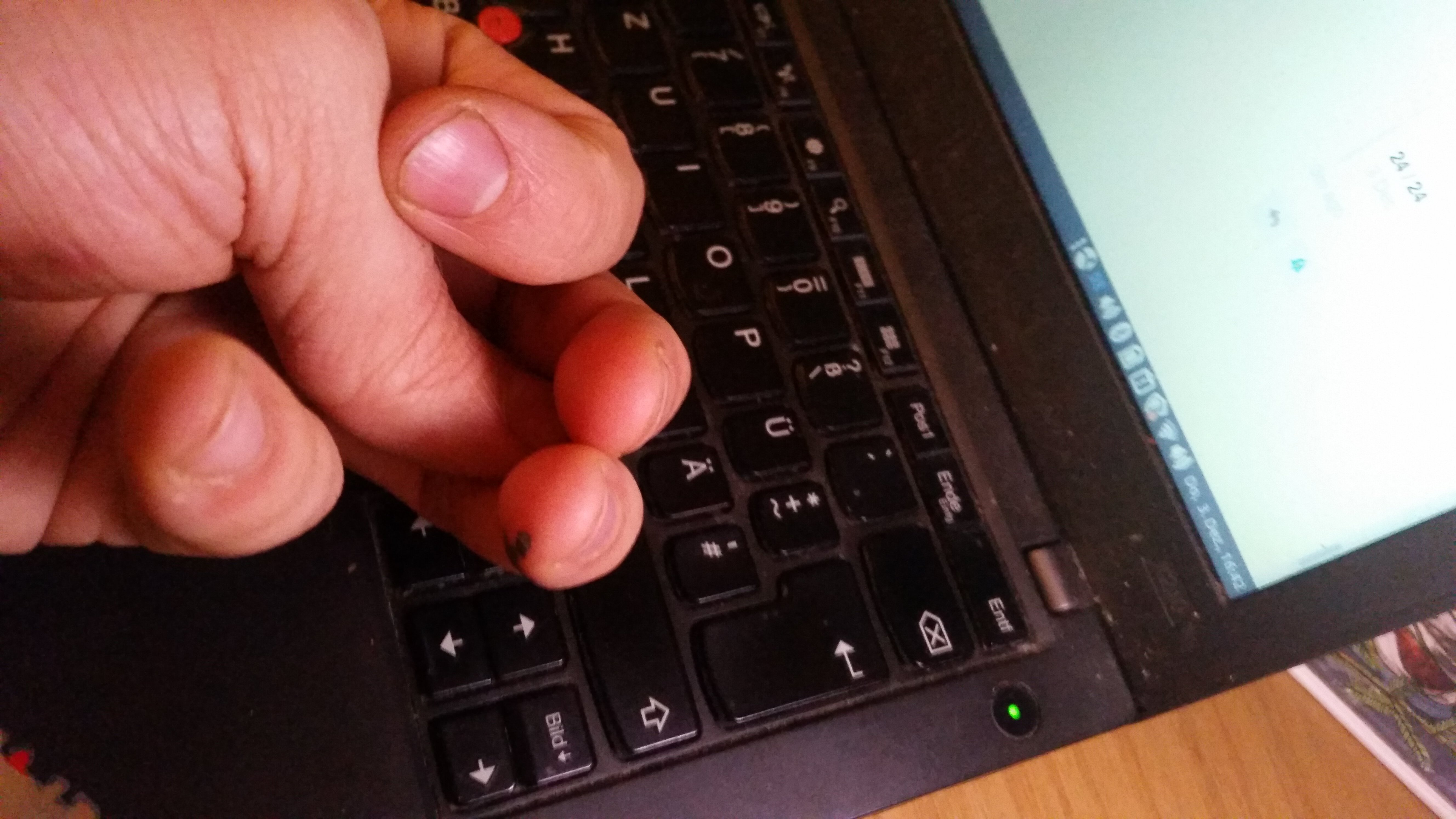

Here other perspectives
Wouldn’t suggest this spot for self install either. From my experience having a nurse implant mine there it takes a lot of force as that is a rather strong area. If you go there I definitely suggest some help or a professional

Hey thanks. Seems like a small target. I personally would come in from the other way.
not sure if it is better.

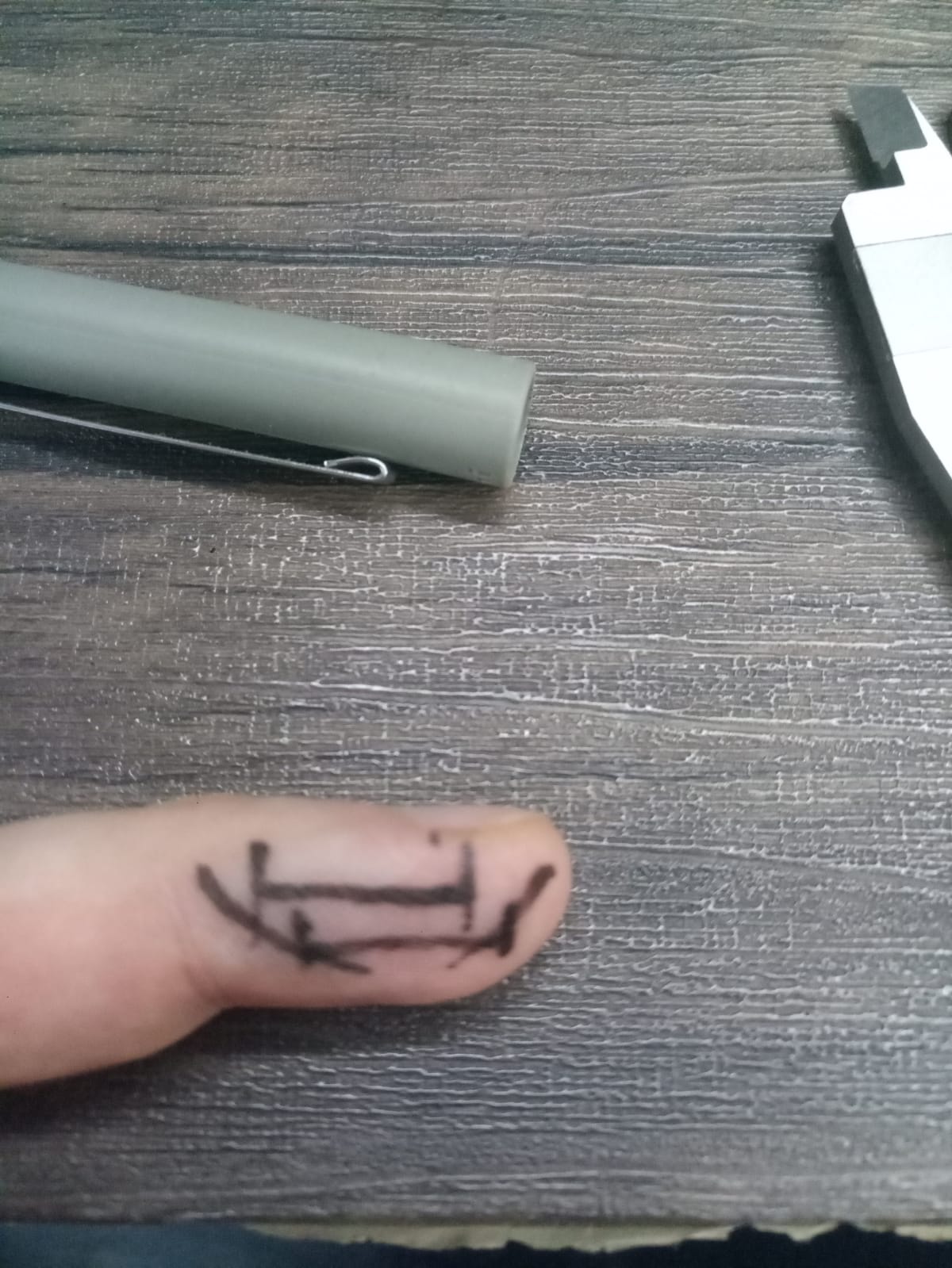

@mrln’s approach and placement seems ok. there are just 2 elements to consider there…
First is xG3’s diameter. 3mm is a lot for a fingertip.
so…
This :point_up_2: is a 3mm space. it is as close to the sides as
reccomended.
And this :point_up_2: is a rough represendation of the wdth taken by bones and essential icky bits which cannot share a space with a magnet.
There you can see a rather undesired overlap…
This does not mean it’s not possible. Quite the opposite: that place is canonical for magnets. but what happens is that the magnet pushes the flesh out and the bits in.
So the maximum diameter we can insert there depends a lot on your constitution.
Unfortunately just like not everyone can accommodate an industrial piercing, it’s even harder to fit a 3mm x15mm magnet on the fingertips.
Although by your pictures, you might be able to fit it in there… but be prepared for possible rejection.

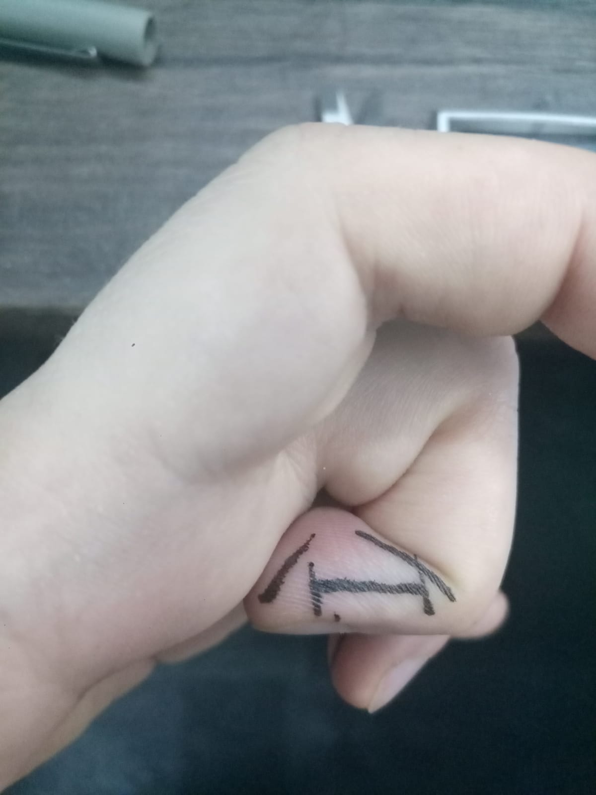

Now for the second issue… the length.
Many people only take the length of the fingertip into consideration, measuring like this:
That works fine for a lateral placement, but you must take into consideration that whenever we grip our flesh changes in ways that a glass cylinder cannot.
So the closer we are to the centre of the fingertip, the smaller is the available length.
These :point_up: Diagonal lines should work as rough safety guidelines. so you might play with placement by following them instead of just moving the measure or 3d model in a straight line.
Sort of like this :point_up_2:
That can also guide you into how close to the centre of the fingertip you can safely place it. ( not that anyone wants a magnet on the middle of the fingertip )
In short, it is of course possible to place an xG3 in the fingertip, but that’ll depend a lot on your anatomy. It might just as well fit in perfectly, get rejected, or just be very visible.
