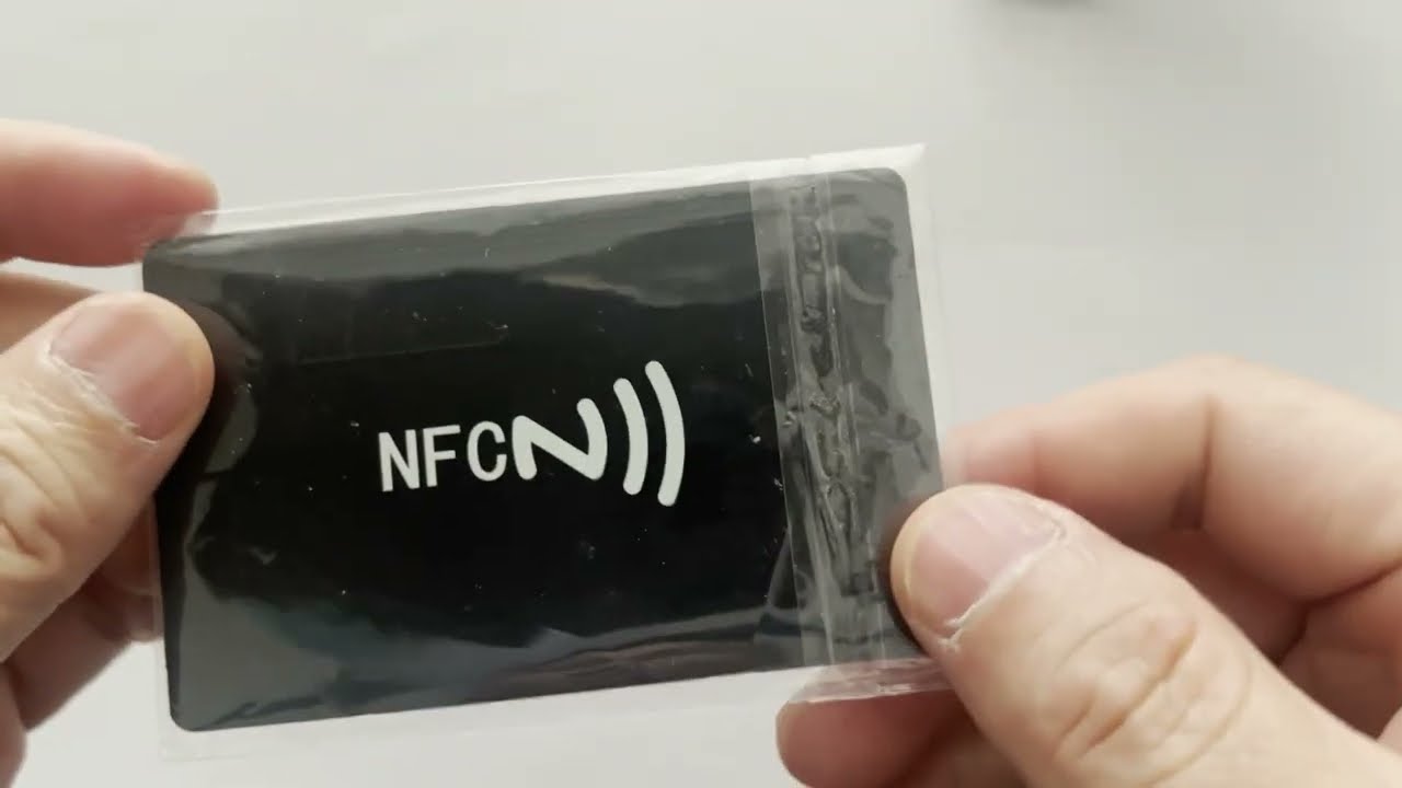

Has anyone used an NFC signal detection card? It looks really cool. Can I buy one to test it out?

I’m developing an NFC reader and need to detect signal strength. These all look about the same.
You will probably want the Field Meter Pro from Midwest Gadgets. This is a good option for quantifying field strength compared to other readers.
For design purposes, a Field Visualizer may also come in handy.
If you plan on making this work with implants, an xFD is a must.
