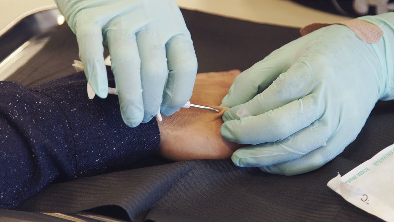

I think it is slightly more difficult to tent the skin, but still 100% doable.
Here is just one example, at the 2:00 min mark
and another at the 13sec mark
Haha, that preview picture is misleading for the pain expectation
Oh yea, I’ve seen plenty of x series, I just hadn’t seen a flex installed from the wrist
In fairness, neither have I, but the whole principle is the same.
